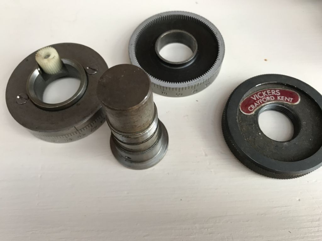

635 forum posts 34 photos | To cut to the chase, hows this come apart!!? I don’t want to force anything but my reason for stripping it, is that it’s already seized solid, and I can’t zero the dial even with the lock ring backed right off. This, it’s hard to tell what should and shouldn’t be forced. Those two holes, are possibly tapped, and m3 screw fits but i’m sure it’s imperials as the grub screws were. Its a vickers dual metric/imperial dial and it’s been jammed since I bought this lathe. No doubt one of the planet gears (more likely, the only planet gear) is damaged. It wouldn’t be a problem as I don’t tend to use imperial (it’s a metric machine) but when I loosen the lock nut to zero the dial, it’s jammed solid, and I like to zero especially with these dials as the major and minor graduations are a bit odd! |

2610 forum posts 312 photos | Perhaps if you add screws to the holes and turn in they may act as drawers/pullers to remove the end plate, I don't think they are for a pin spanner because of the threads. Emgee |

![]() 550 forum posts 190 photos | Hello Russ, These are very nice bits of kit. I have some NOS ones of these and will dig them out to check the disassembly method. I think there are some instructions I have on fitting and maintenance, but will need to dig them out tomorrow. From a very cloudy memory there is a hub held in by a snap ring (eared external circlip style) which should be on the outer side from your photos - the side visable in the photo is the machine side rather than the handle side. The slot between the two holes takes a pin (set in the, say, cross slide casting for example) which is the restraint for the centre hub. I believe there are two planet wheels, one for each of the dials and the clever bit from memory was that they were identical tooth wheels but of slightly differing diametral pitch so giving a differential gearing. Be patient and I'll get back to you ASAP!

Russ B | 07/10/2020 11:36:22 |
635 forum posts 34 photos | Posted by Oily Rag on 07/10/2020 00:03:05:
Regards, Martin Edited By Oily Rag on 07/10/2020 00:10:50 Martin I look forward to your reply. I have now managed to get in to it. The two tapped holes are a red herring, they secure the centre steel plate to the backplate retaining the driven gear/dial.
It was simple a case of tapping the threaded end of the shaft back though the assembly. It was incredibly tight due to damage and burs on the shaft from a previously botched repair. To worsen matters the black steel hub which is a press fit into the driver gear/dial has been beaten to death with a hammer on the inside spigot which is a close fit inside another shaft, which caused it to seize.
Add to this that the press fit hub isn’t pressing all the way in, and they are the main causes of the issue. Someone’s had a go at fixing it, and beaten it to death. I’ve done my best to dress it up with a file and stone but Vickers really put some close tolerances on these things so it’s still drags slightly here or there. I need to determine why the hub isn’t pressing all the way in tonight because it’s causing the driver gear/dial to rub on the steel centre part (which is secured with those 2 internal screws). The plastic gear inside is toast but I’d be happy just removing it for now if this press fit weren’t rubbing and seizing. Currently the only way to use the machine is to loosen the lock but fully and allow the graduated metric ring to spin freely, which makes it hard making things to a dimension! |

![]() 550 forum posts 190 photos | Here is the strip of my unit - more photos in my album "Vickers dual dial handwheel indicator" for those that are interested. edited for 'spellin mistakh' Edited By Oily Rag on 07/10/2020 12:46:24 |

635 forum posts 34 photos | Yes the photos would still be very useful considering mine still doesn’t work on reassembly! As i’ve said i think the steel hub isn’t pressed all the way into the driver/dial. This steel hub locates against the face of the first step on the shaft and because the gear/dial is standing proud it’s locking against the middle fixed steel plate when there should be a very small clearance I had initially wondered if I was missing a shim, but given the close tolerances of everything, Vickers probably didn’t need to shim anything! Edited By Russ B on 07/10/2020 12:48:10 |

635 forum posts 34 photos | Those photos confirm no shim. Is the driver dials steel hub pressed flush with the graduated gear ring (the side against the table in your photo) Does anyone know where the little plastic gears can be sourced. Size wise i’m not sure how big mine is. I’d say they functional top slide one is about 1.1/2” maybe 1.3/4” and the troublesome cross slide is maybe 2.1/4 ish, from memory which just looking at post seems to make sense. The fixed steel mid section is thicker on yours with countersunk screws, mines just a plate with regular pz2 screws (not metric) |
Oily Rag | 07/10/2020 14:04:48 |
![]() 550 forum posts 190 photos | Russ, Starting from the rear of the assembly (i.e the face which abuts to the machine slide) the centre hub has a 0.010" stand proud, the rear satin chrome ring - metric grads is 0.0075" less than the 'hub'. Holding the hub and rotating the satin chrome ring the plastic gear wheel spins freely. Assembling the Imperial graduated satin ring onto the centre shaft the rings become locked to each other when turning one against the other - as you would expect as the nylon gear interferes. The plastic gear protrusion prior to assembly is 0.1225" and the depth of the internal ring gear in the Imperial dial is 0.1245" measured from the dial periphery. Measured to the hub centre spigot it is 0.130" Just to clarify this is the measurement from central hub spigot to the bottom of the recess - think this then allows the dials clearance to spin freely when the hub and centre shaft are clamped by the black knurled outer ring. This makes the black ring the dial unclamp/clamp system. The black knurled outer ring - retained by the thread and a circlip releases the assembly to allow the dials to spin to a zero position (depending on whether you want Metric or Imperial). The plastic gear is 0.476" dia x 0.4305" long with a 0.1876" hole (measured by pin gauge) the teeth are 30 (or 31! - need to get my eyepiece out) which makes them either 67DP or 69DP probably a modified 68DP? might be reproducable by my instrument restorer?! and made in brass?? I'll take some more photos of these points and put into the album later, bit busy at the moment so apologies for the delay. Hope this is helpful Regards, Martin Edited By Oily Rag on 07/10/2020 14:08:13 for clarification Edited again to add bit about instrument restorer making a new gear Edited By Oily Rag on 07/10/2020 14:15:00 |

635 forum posts 34 photos | So, my steel mid section is actually thicker than yours, exactly 3/16” in the centre. It’s obviously been rubbing this for some time as it’s worn down a thou around the edges. I’ve determined from careful measurement and sketches an interference between the steel mid plate and driver wheel of 0.1305mm or 5 thou, it’s right there on paper, double checked the dimensions and laid it out twice. No way around it, it just doesn’t work. If my mid steel plate was 4.5mm like yours, I’d have exactly 5 thou clearance..... sounds comfortable to me. I need to get some 4.5mm plate or find someone with a small surface grinder!! This where I got the idea maybe I was missing a shim on the shaft, to space the wheel off the steel plate slightly. Edited By Russ B on 07/10/2020 22:11:27 |
