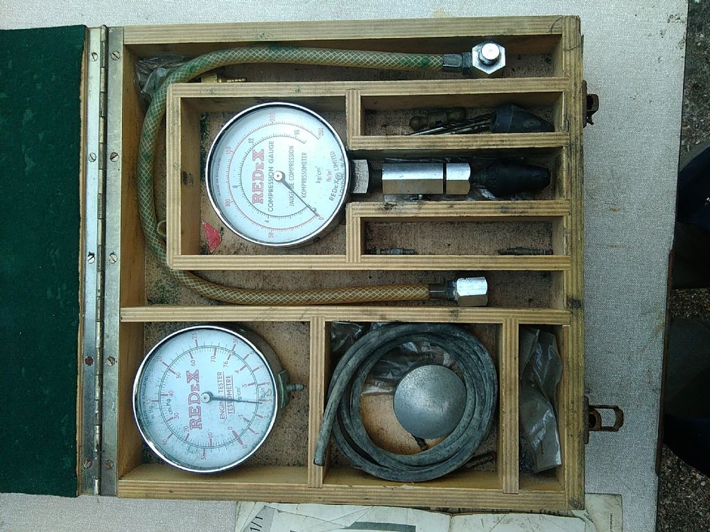

Redex used to market these for checking compression through the spark plug hole. Most useful on multi cylinder engines to check for burnt valves or broken rings.wp_20171022_17_14_32_pro.jpg
