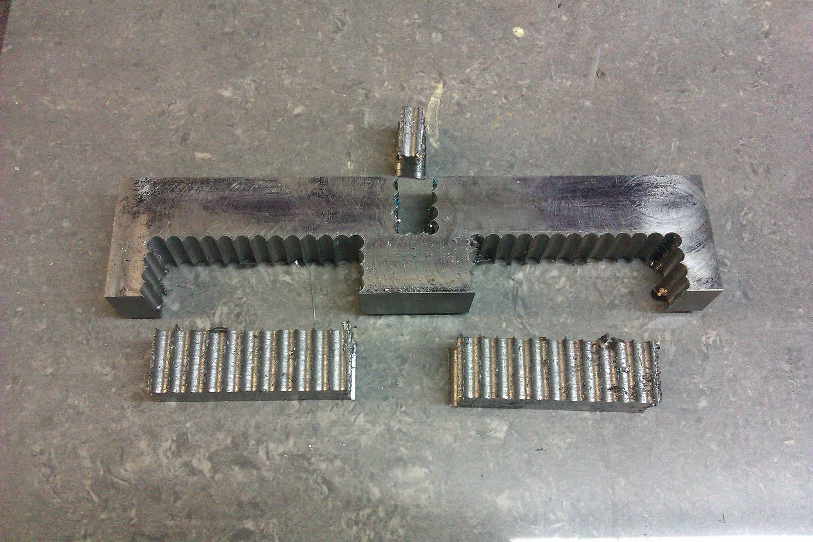

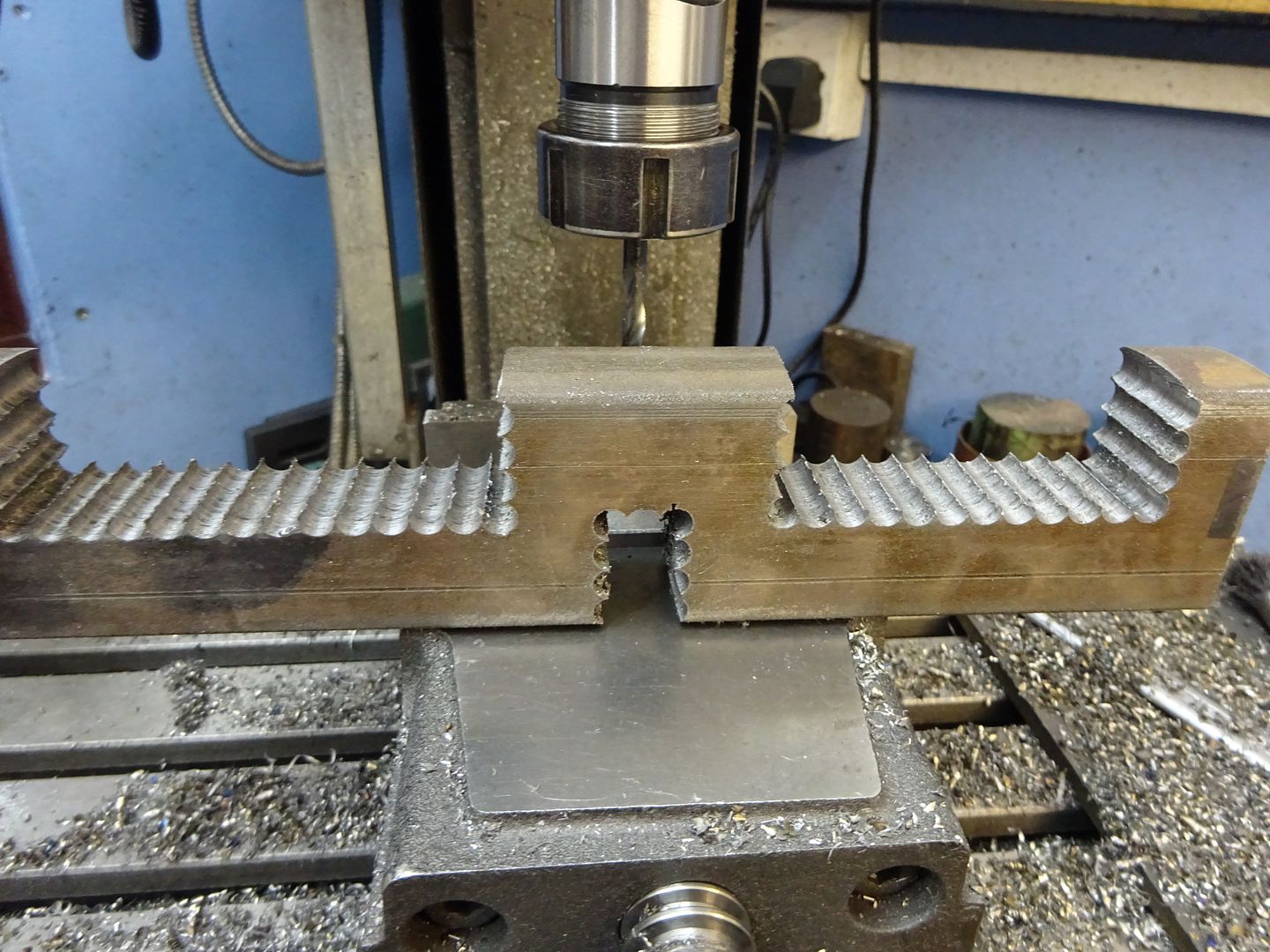

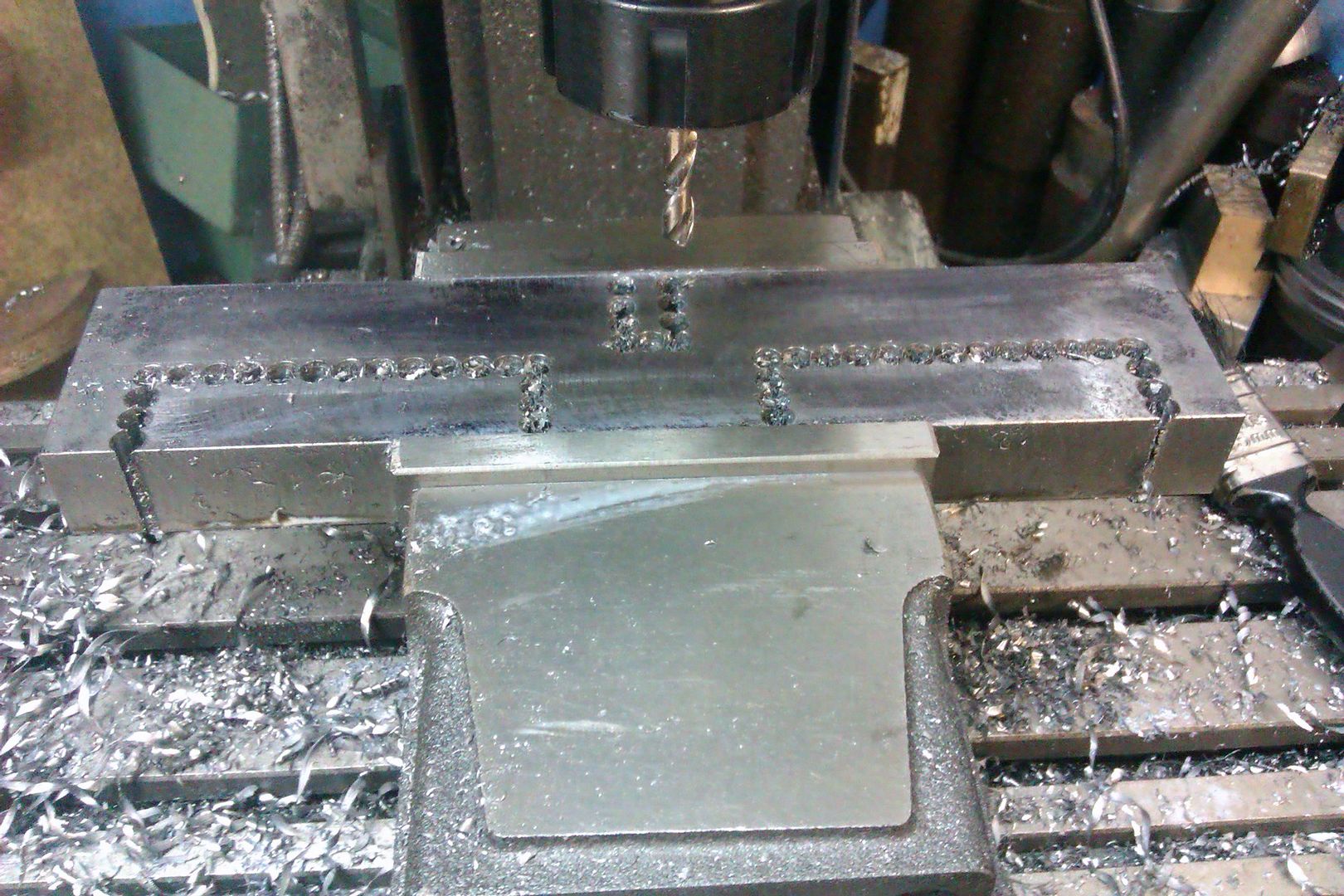

Although I do loctite some of my smaller crankshafts (with 648) I would never be happy with that method on an engine of that size. Either cut from solid if a casting is not available or silversolder and pin as a lesser option. You don't need to do much sawing if you stitch drill out the waste.

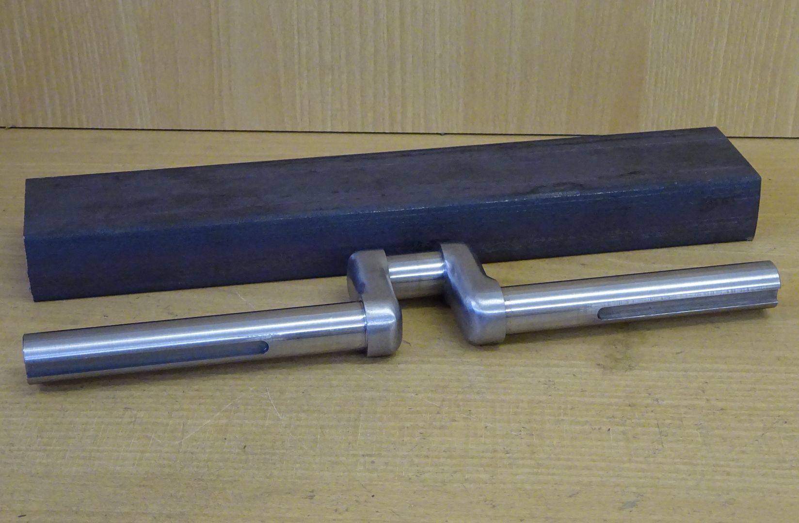

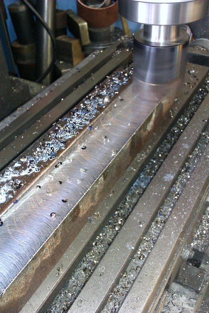

Ideally avoid using bright bar and if you have to use it then leave plenty of material so that when it moves you can still get the part out of what is left.
That one was cut from some unknown steel flame cut from 2" thick material that was cleaned up first.
On that one I could actually see the two ends curling away from me as I drilled the series of holes, the two ends had probably moved a 1/32" to 1mm by the time they were all drilled.
Ideally start with black ( hot rolled) bar which does not seem to move much, this was 50 x 25 stock that was pickled to remove the mill scale first.
In all cases I like to leave them for a couple of weeks after the stitch drilling to settle before roughing out and will then leave for another week or so before finish machining, this is the one above and some of the remaining length of bar.
