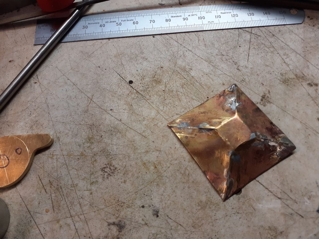

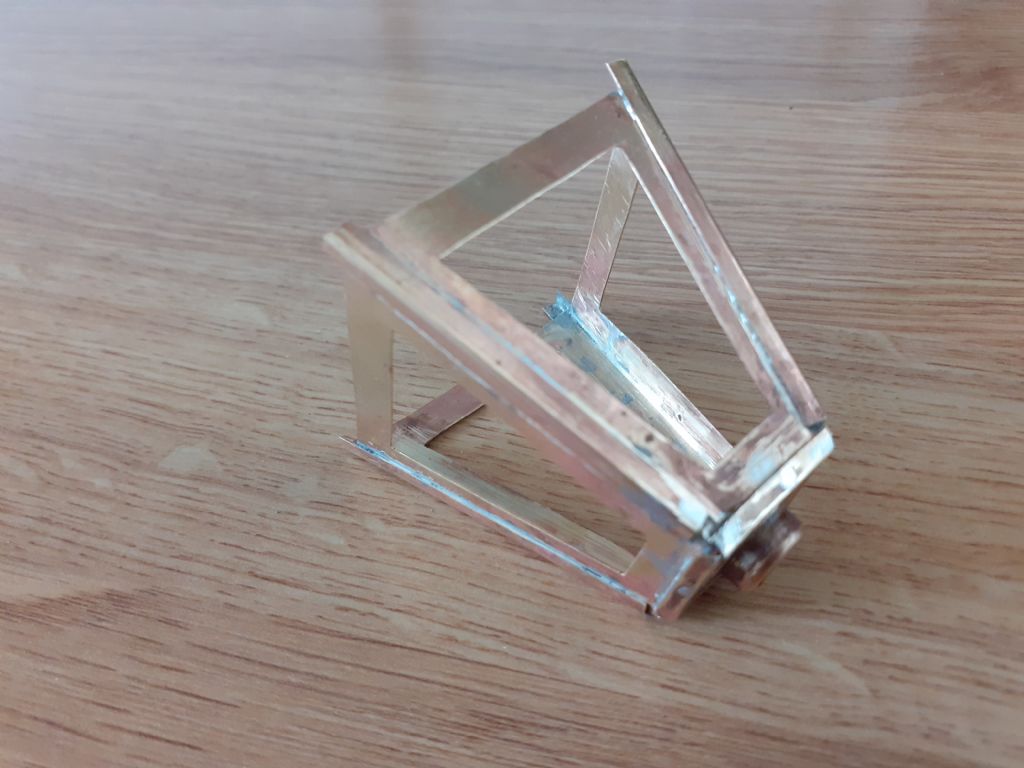

I have decided to add a lamp post and generator to my wobbler engine I finnished a while ago. Here is the lamp for the top of the post.

Jim Nic22/07/2020 19:23:17
avatar
406 forum posts
235 photos
That's a very nice looking fabrication david. Well done.

A good job on your lamp, interested in how you made the lamp cover David.

Hi
Bob I
had a go at cutting out the shape and silver soldering the join but it started to melt although I used a low temp jewlers solder. I had a go at lead soldering it but it was a pigs ear. 20200727_102220.jpg
I then made a wooden press tool from a piece of oak on the mill with a couple of pinns to locate the two halves. I anealed a piece of brass and pressed it in the vice with a small amount of getting it worked well.

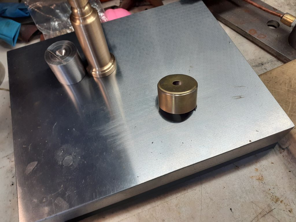

Just a bit nearer. Made part of generator to power the lamp post. Cut a plate to mount the motor on. Made a strip and end cap and soldered together. The cap was anealed and spun on the lathe to make the shape on a former.
The retaining lugs were bent and drilled and a ferrule made and soldered for exit for wiring to lamp.

Very good work David, l like the former as well.

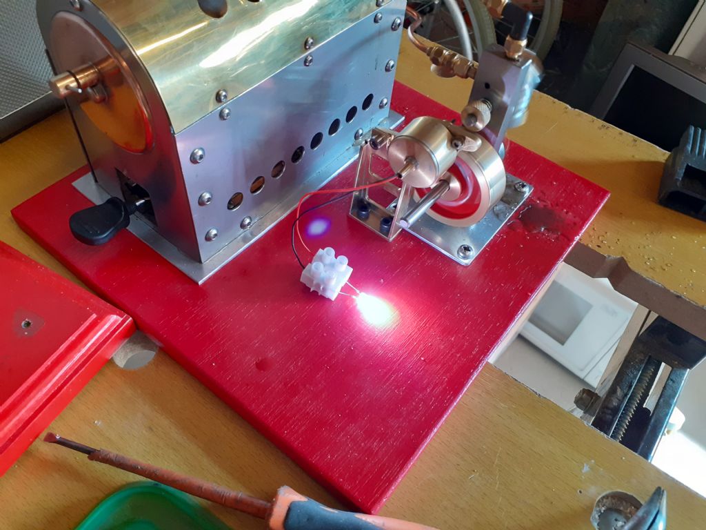

I have made the bracket to support the motor/generator and decided to check out if it works ok.
I powered up the wobbler and no problem.
The output is 3.2 volts and so time to Finnish the lamp etc.

Hi John I bought them from RS
3.2 V White LED 5mm Through Hole, Nichia NSPW515DS
I had to turn the flange off the base of the LED body so they would go through the tapped 6mm hole.

That's it finnished at last.
I have had the first run since completing it. Hope you like it.
