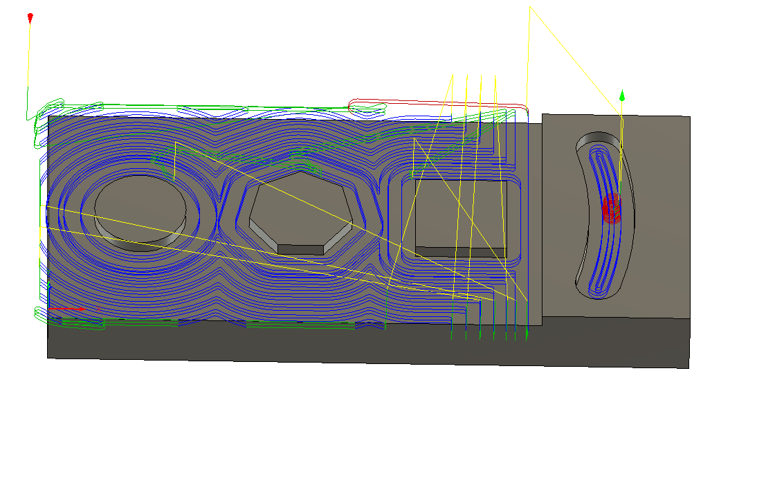

Seems my numbers are not a long way off. This is the tool path in the CAD:
A variation on the Circle / Triangle / Square as a test piece to make sure the Mill cuts to size and make any backlash visible. Its roughly 30mmx70mm
The cutter last night failed to get through the first 0.5mm layer. It had done most of it, then snapped as it started to do the square section.
The surface finish was quite good, but there are burrs thrown up.

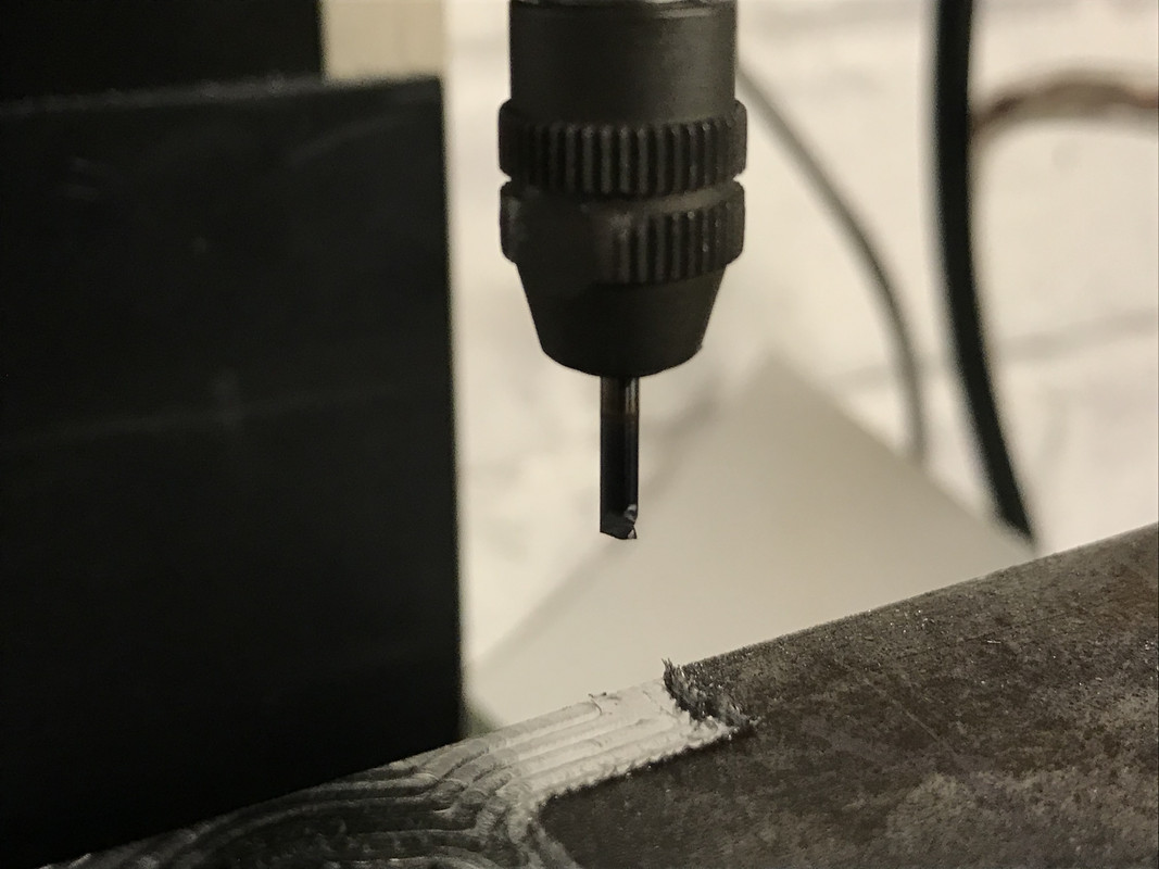

I cant get any less stick out - the shank is as far into the chuck as possible, and the flutes are quite long.
Heres the snapped cutter:
It snapped in the little 'notch' as it began the next pass around the square.
I did notice that it seemed to be mostly taking full width cuts - on a manual I'd usually avoid that - is that a parameter somewhere and should I change it?

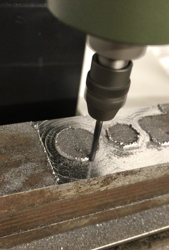

There's no polite way of saying this, but the finish shown is awful. sad
The pocketing on both sides of this steel part was done with a 3mm cutter - no deburring needed:
However, the reason that the cutters are snapping is waaaaaaaaay too much stick out of the cutter. Looking at the finish on the flat parts there appears to be chatter, caused by the excessive stick out. In due course I'll take a picture of one of my 2mm cutters for comparison.
Andrew

1) your end mills seem to have really long flute sections and stick out from the chuck a fair way. This will increase chatter and increase the risk of them breaking. Unless you need the increased flute length, I'd suggest something with shorter flutes and a thicker shank. I've had good luck with these
2) You seem to be taking full width cuts. If I do this with small end mills, it tends to be because I am cutting out something like a clock wheel and want to use the CNC as a kind of scroll saw. In this case I find that a depth of cut of 0.2mm is all I can handle before tool breakage.
For facing and adaptive clearing operations I tend to run with a width of cut at just under 1/2 the diameter of the end mill I'm using.The setting for this is under the "passes" tab in the toolpath in fusion 360 and will be called "stepover" or "optimal load" depending on which type of operation you are doing.
3) assuming you are running a 2mm, 2 flute end mill at 0.9mm stepover and 15k rpm the minimum feed rate you should use (according to g-wizard) is 107mm/min. Any less than that may give rubbing. for a 3 flute this goes up to 161mm/min. Personally I'd be tempted to back the speed down to 10k rpm and use 70mm/min for 2 flutes and 107mm/min for 3 flute.

Here's a picture of a 2mm diameter 2-flute uncoated slotdrill:
Note that the working length of the cutter is quite short. I'd be running this with the collet closing at the top of the flutes, so less than 10mm stick out. I used this style of cutter to form a series of fins on a liquid cooled heatsink for an experimental high power inverter. The gap between each fin was 2mm and they were 4mm deep. I ran at 4000rpm, full width, 1mm stepdown and 150mm/min feed in 6082 aluminium. Each heatsink had 18 gaps and I machined 8 heatsinks, all with the same cutter.
Andrew

You can always cut the end off the shank with something like a Dremel cut off tool so you can just have the flutes exposed. I'd also go for a short or standard series cutter so you should be able to get a 5-6mm flute length no problem.
I think F360 defaults to 90% cutter width, I tend to use 60-65% on a surfacing cut but on your test piece would more likely go full height but 10% of cutter width on a small cutter like that.
Definately would not be wanting burrs like that which usually indicates a cutter that has become blunt or is otherwise not cutting as iy should.
F360 allows the file to be shared, if you post a like I'll set it as if I were cutting than you can look at that to compare. If you go to top left Icon, select "Share" and then "public link"

I've added another setup with smaller stepover, and DoC. It was doing 1.9mm stepover. Hopefully I can try it tonight when I get in from work
