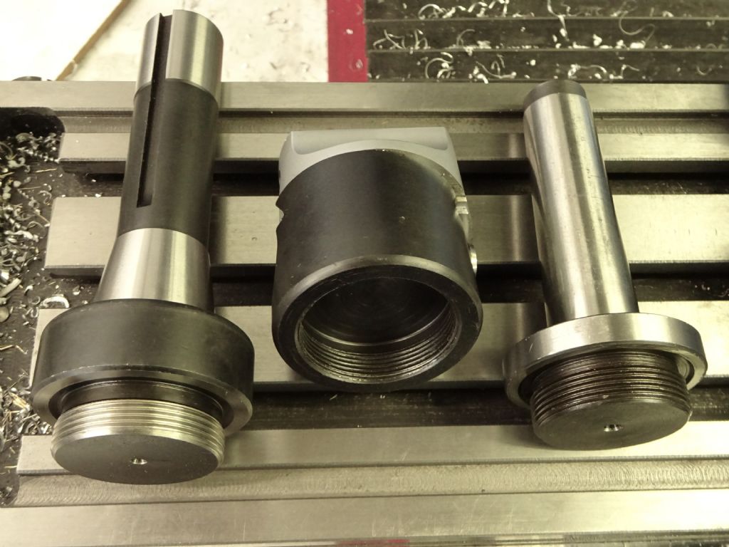

I recently purchased a boring head from Arc, it has turned out to be a great purchase and has already paid for itself, however I did come across one issue which has puzzled me, as follows.
I wanted to enlarge a hole in a sheet of plastic (perspex I think), the sheet was too large to be held in any way on the lathe cross slide so the mill was the only machine able to perform the task. The problem is that all of the tools that come with the tool are for an anti-clockwise rotation. My mill will and did run in reverse in order to achieve the desired result but I had to take very small cuts to prevent the head unscrewing from the R8 arbour.
Apologies if I have been a muppet but am I missing something here?

It's the head coming off it's arbor that is the issue when running in reverse not the arbor coming out of the spindle

Jason is correct, it was the thread on the arbour screwed onto the boring head that was coming loose. Luckily it didn't happen enough to stop me completing the job but I had to take a lot more time than I wanted. I guess I need to look at grinding the two hss tools that I have for the boring head. To be fair the supplied tools were tips brazed onto the shanks and seem to be very well made and it was only the orientation that made things tricky.

If you are never going to use any other arbor on that head I'd just loctite the two together.

Chris, the trailing edge of the supplied tools are usually curved so that when you run them horizontally the curved edge needs to do the cutting which is not ideal. But if ground as shown by teh broken green line they work so quite easy to modify

For the OP, the LH drawing is how the tool is supplied with anti CW boring bars, so you have to run it in reverse to do cuts with the boring bars in vertical.
What I'm trying to suggest is mounting the bar horizontal in the side, turn the cutting edge to face down and run the mill in fwd direction. As Jason says the geometry of the cutting edge might need some adjustment but nothing major I think.

Bit of elaboration of my earlier sketch showing how a supplied tool would offer a rounded cutting edge on the left and the modified tool on the right when used horizontally
The modified tool can still be used for boring when mounted vertically, infact a bit less chance of rubbing in smaller holes
