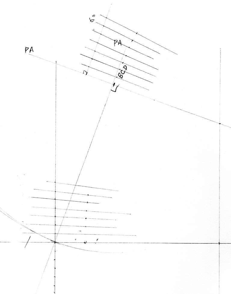

Perhaps cut a base circle from plywood, plus a length of string and a pencil, which would provide a suitably accurate involute for this project. Or even get the long-unused compass set and protractor out, and draw it.
Bill
Bill Davies 219/06/2020 14:10:53
357 forum posts
13 photos
To show it's not too tedious to draw the curve, here's part of a scan of an A3 drawing I made a few weeks ago to give me some idea of the error between a circular arc and an involute, so I haven't actually drawn the involute, just tested various radii to detemine the fit. It's not very clear because the pencil drawing was quite light; I've attempted to increase the contrast. The scan is in my album.
