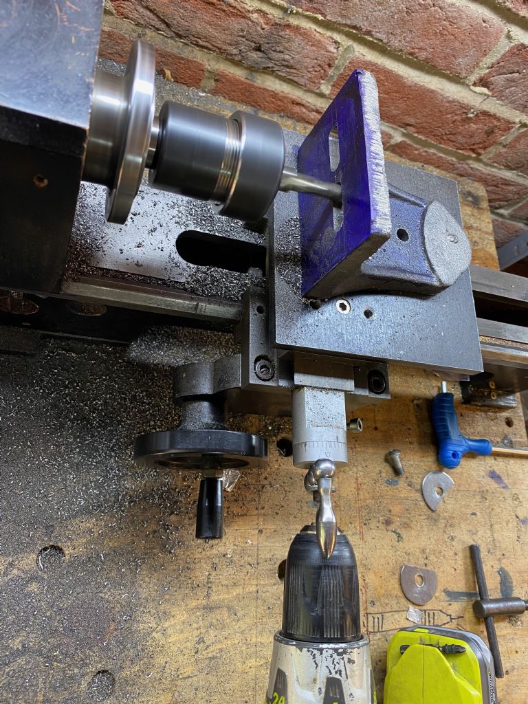

I recently decided that it was time to do a "proper project" on my little mini lathe after years of just using it to make knobs and prototype small aluminium parts for work.
After far too much deliberation over a good first project I decided upon a sawing and filing machine from Hemingway Kits
Well, I placed the order and the castings arrived within a few days, all nicely packaged and with great instructions.
original castings
Despite being intimidated by the size of the castings, and never having machined cast iron before, I decided I'd better make a start on the first casting.
The first job was to drill a couple of mounting holes on the standard.
marking out
I marked them out (using an off-cut of granite worktop as a surface plate) and then realised that I would need the markings on the other side of the casting in order to drill the holes.
I couldn't work out how to lay out the centre line on the other side of the casting as the bottom angle was in the way, so after a ponder and a cup of tea I made up a drilling guide and used it to drill 2 (almost perfectly square) small holes using a cordless drill, before enlarging the holes from the other side on the pillar drill
transferring holes
Now I had the holes in place I could mount it on the cross slide of the lathe. Not wanting to drill holes into my cross slide, I made up a plate that I could bolt onto the cross slide and drilled + tapped M8 mounting holes into that. I also took the opportunity to make a quick saddle lock and a fly cutter for the faceplate.
faceplate fly cutter
My first attempt at fly cutting was a disaster, if I took a deep cut then the lathe stalled and if I took a light cut then the cast iron ate away at the (hardened) silver steel cutter.
I then tried an HSS tool in a bought fly cutter (which I didn't want to use as it would have a smaller sweep).
I found exactly the same thing with the HSS tool, any cut that the lathe could actually take just caused the tip of the HSS to be eaten away
The last ditch attempt of an old brazed carbide tool in the fly cutter (I've no idea if this is recommended use!) cut really nicely.
carbide fly cutter
As the width of the piece was more than the travel off the cross slide, I bolted it to one side of the plate and then moved it to the other side (aligning it with a dial gauge). The HSS blanks under the standard are to pack it up to centre height.
I had a few issues with the alignment as the base of the casting wasn't exactly flat and I couldn't get my packing pieces in exactly the same place after moving it, but I'll come back and clean it up after surfacing the base.
Next job is machining a couple of slots.slots
I pre-drilled the holes either end of the slot (and one in the middle for good luck) and removed the waste with an old 3/4" end mill. These were done in 3 passes, and it took no time at all with the power feed on the cross slide :D
Next, I've got to surface the other face of the standard. As this is much higher than the one I've just done and to avoid complicated fixtures I'm going to attempt to machine it on my little 3040 CNC router. Wish me luck!

Neat solutions to the setting-up problems, and I like your faceplate fly-cutter holder.
Regarding the HSS tools blunting quickly, Hemingway supplies good-quality materials but cast-iron normally does have a thin, hard surface. It is likely that the depth of cut your lathe could handle at that large fly-cutting radius, was insufficient to undermine the "skin".
The carbide tipped tool you ended up using as a fly-cutter would have been hard enough to cut through that surface.

Thanks for the encouragement, and, Nigel, yes that sounds like exactly what was happening - I'll now know for next time
Anyway, I had a couple of spare hours this evening so I thought I'd try machining the other face of the standard on the little router.
Unfortunately the bed isn't perfectly flat so I superglued some delrin spaces in the area under where I wanted to mount the angle plate and faced them off flat.
Next I bolted an angle plate over these and mounted the recently fly-cut face to that, As I couldn't get a consistent reading off the cast face to align it, I used a parallel over the top to take reading with the dial gauge. Is this the best way of aligning a rough casting, or are there better ways?
I can only apologise for the state of the router - it is in desperate need of a good clean smile d
I was dubious as to whether by little router would be able to cut the cast iron, but I found that by taking light passes it cut fine.
I noticed though that the vibration was causing the Z axis stepper to lose/gain steps no matter what depth of cut I took. I think the holding torque on the stepper wasn't enough to keep the tool heigh steady. Luckily I had another Nema 23 stepper and driver lying around (for another project) so I swapped the old one out. You can see the old one on the right below, according to a web search it has a holding torque of approx 0.5Nm, whereas the one on the left has a holding torque of 3Nm.
Spent a happy 10 minutes wiring in the driver and replacing the stepper - I'll mount it properly soon, I promise!
The difference was night and day, no movement at all in the z axis when taking cuts.
I was using a 6mm carbide 2 flute end mill on a 2D adaptive toolpath with stepover of 0.4mm and a depth of cut of 0.5mm at a feedrate of 2000mm/min.
It took about 20 minutes to face the entire surface, and I'm very pleased with the result, the camera makes it look bad, but you can't feel any ridges and it is perfectly smooth to the touch. I just need to take another cut or 2 to get past the marks at the bottom.
As you. can see, there is now an "extra hole" right at the top, caused by me pressing the wrong button and plunging the end mill straight into the casting.
Does anyone have any bright ideas about how to fix it?
I'm wondering about drilling all the way through and threading a piece of mild steel into it, but I'm sure there's a better way.
