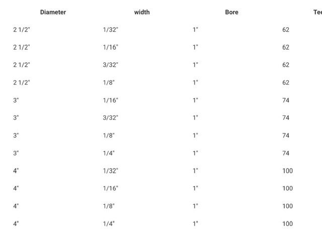

Hi, I’ve never had much luck with slitting saws. I struggle to get the speed right, they jam, and the cut also drifts away from where it should go. Clearly trying to do this with an assortment of random slitting saws I acquired is adding to my issues ( I guess itS sort of the same question as ‘ I can’t get a decent finish on this material I’m turning, To which the more experienced ask ‘ what material exactly is it? Answer I don’t know! I’m planning to purchase some new blades and start with the right blade for the job. I would need to slit aluminium, stainless steel and regular steel. I have a gift voucher for Chester so plan to use them. To this end which blades (diameter and teeth ) should I purchase? I enclose a screen shot of the blade options they have. Many thanks in advanceb24a8b39-d25d-40cd-89a2-865a43d454dd.jpeg

They all seem to be fine tooth saws, so only really suitable for shallow cutting, such as slotting screw heads. For deeper slots you need coarse tooth saws. Here's a picture of several saws (all coarse tooth apart from bottom right) for comparison:

Ideally for deep cuts with a coarse tooth saw the saw needs to hollow ground to reduce rubbing in the slot.

If getting from Chronos then go with the 3" x 30T if you want imperial widths, none of their metric offerings look that fine (they do use one photo for all) so if you want metric then I would go to say ARC who have coarse ones.

As well as tooth count you need to take note of the hole size compared to saw diameter, a 2.5" diam blade with a 1" bore will seriously limit the depth of cut the saw can make, you have to have a big enough diameter on the arbor and securing nut to provide sufficient grip, without a keyed drive the saw will slip on the arbor and is sure to jam in the cut.
I think you will be best served by a 1/16" thick blade, any thinner and they can easily wander off course if fed too fast.
If you can use flood coolant to keep the chips clear the finer tooth blade will give good service, if no coolant you will need to go with the coarser tooth count as stated by others.
Carbide are far better than HSS but cost a fortune.
