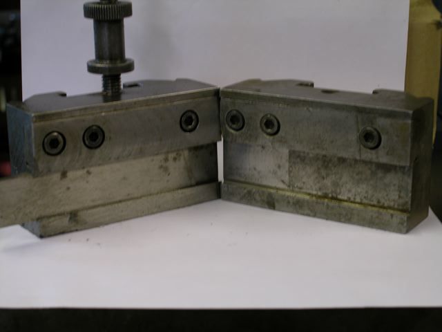

The factory Dickson toolpost blade holders use a full length bar of truncated triangle shape that simultaneously pushes the blade down into the bottom bevel and holds it back against the body. End on view in top picture shows the blade is held at the right angle to get clearance on both sides of the cutter as mentioned by Jason. Left hand one is a special wedge I made to use shallower blades in the Dickson holder. I had two sizes in my stash.

You can get the idea what Clive was mentioning on these two parting tool holders made on the shaper for my Dickson QCTP.
