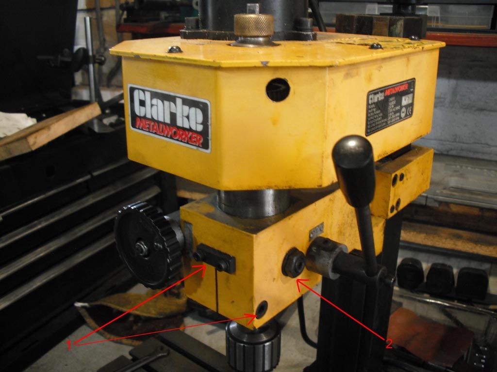

In the photo, I have marked two sets of adjustments and am curious to know if either of them is the proper lock for the downfeed.
No1 is a plate with slotted holes and an adjuster screw which would open/close the slit. I adjusted this once when the machine was quite new, to remove a slight bit of play in the quill. I have seen some modification sites where a lever has been added to the screw to use as a lock. This seems wrong to me.
No2 is a 10mm hex socket screw with a washer and locknut. When the lock nut is released it is possible to turn the screw almost 1/2 a turn in either direction before it stops. at this point the down feed is locked. The screw is not even shown in the manual that came from Clarke. An on-line manual shows it as an adjuster screw in the exploded diagram, but there is no mention of it in the user instructions. I would just like to know if it's OK to use this as a lock or would I likely to cause some damage. Hopefully someone will know.

Mine doesn't have the plate with slotted holes, but does have the allen screw screw you have labelled "1" and it is this which is definitely the quill lock! I replaced the allen screw with a handle, on mine.
The other socket screw, with locknut, is set to minimise the play on the quill I believe - the screw bears in a slot which runs down the length of the quill, hence why it locks the quill when tightened. I'd use the other one as a lock, if I were you.

Number 2 is probably a peg in the slot to stop rotation of the spindle sleeve and everything attached to it. A small amount of peg rotation may act as an adjuster to minimise rotation but still allow movement up and down. Plate item 1 looks to be a spacer for mounting the chuck guard on judging by the photo on the Machinemart web site. Screw item 1 as Tom said.

No 1 is used to mount the rather annoying guard on my SX-1 mill - there was a mod by Meek? to add a lever to No2 to easily lock the quill

I recently purchased one of these and it's still shiny & new but yours looks as if it's seen a bit of service. Working on the premis that both our machines are identical and there haven't been any upgrades/changes, number 1 is actually two seperate things.
As Frances notes, the flat plate held with 2 small setscrews, is a load spreading plate for the annoying plastic guard. It serves no other purpose other than to prevent the screws digging in to, and weakening, the plastic guard.
The other part (the recessed M8) is I believe, a very primitive method of taking up play in the main spindle sleeve. I had a go at nipping it up to try and get rid of a slight wobble in the spindle box but it very quickly locked up the whole head assy! As I said, very primitive.
I believe number 2 is supposed to be the quill lock but again, it's another very primitive effort that would benefit from a lever or handle so searching for the mod that Frances refers to might be worth a go. To date though, I haven't found a need for it.

So you want to lock the quill in place while milling? What is it that makes you think a small screw going in the side of the quill is a better way of clamping than the cap head allen screw which squeezes the entire casting around the quill in an even manner?

As Michael pointed out, that small screw is not for locking the quill, but for stopping it from spinning.
The slit in front is a method used for clamping that has been used on many machine tools, there's nothing strange about it.
You say it's difficult to readjust after being clamped tight for milling, I'll have to take your word as i don't own one.
So what I'd do is drill and tap a hole the same just above it, use the top one with the cap head allen screw adjusted for drilling, use the lower one (which should clamp a bit tighter) with a ratchet style lever clamp, that can be tightened when milling.

Well I went into the workshop this morning with the intention of making a lever operated bolt to use as a quill lock. I tried the hex key in the original bolt which every one seems to think is the actual lock. I was unable to apply enough leverage to lock the quill, although it did make the down feed action a bit stiffer. The machine is 12 years old so possibly this is due to wear, but it hasn't really had that much use. I am now at a bit of a loss as to what to do next. I do not want to use a bit of tubing to get more leverage on the bolt for fear of shearing it. Any lever operated mechanism I made would not be any longer than the hex key anyway.

I can’t find a gentle way to say this, so please forgive the blunt approach ...I think it doesn’t lock for the same reason as you needed to use it the first time : The bore in the casting is too big for the quill.
It may be possible to use it as an adjuster, and add a separate locking mechanism ... l can only suggest that you take some careful measurements and report back.

About the problem of it not closing up properly, take the m8 cap screw out, try a small depth gauge down the hole, see if it's possible the screw was bottoming out, which might have caused it to not tighten further?
Another way to check this would be put a G clamp across the front to squeeze the casting together while the screw is out, see if that works? If it does your screw might have bottomed out in the hole.

Sorry guys. the screw has definitely NOT bottomed out in the hole, because it goes ALL THE WAY THROUGH. I've only had this machine since 2008 so I can't understand why I've never noticed it before.
