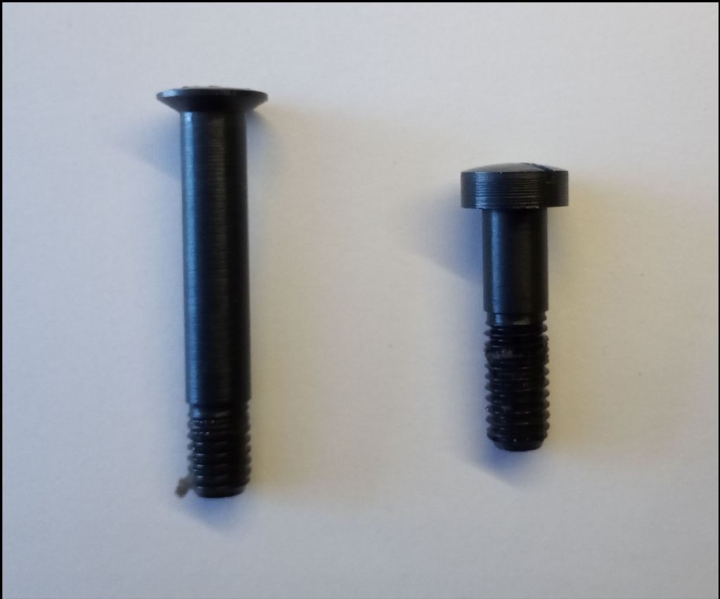

25/10/2021 15:16:17
LH screw:-
o/all length = 37.3mm
Head diam = 10mm
M6 thread
Threaded portion (to the shoulder) = 9mm
Plain shank (under head to the shoulder above the thread) = 26mm
R.H screw:-
o/all length = 26mm
Head diam = 9.8mm
M6 thread
Threaded portion = 12.5mm
Plain shank = 9.5mm
Head thickness = 4mm
Max torque loading on these will be 4.5Nm
I think the above covers all the detail and I'd be looking for 2 off of each screw.
25/10/2021 13:47:21
I'm hoping someone on the Forum can help me here.
I'd like to find someone that can make a set of 4 screws for me, in order to replace some damaged items.
Screws are M6 thread and need to be either SCH or Torx but the length/profile/heads are not standard so will need to be adapted from existing screws or made as 'one offs'.
I lve near Wisbech, Cambridgeshire and don't own a lathe to make them myself, hence the request.
Anyone?
Iain
