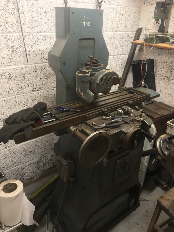

Evening All,
I have finally, after many years, got my 540 wired up and filled with oil.
It runs
I understand the ways are lubed by the hydraulic system, but how "wet" should they get? They don't seem to have much, if any lube, so is it possible that whatever passages are there have got blocked?
Alan Waddington 222/04/2020 22:05:26
537 forum posts
88 photos
Very wet, lift the table off and run the machine, you will see the little oil holes, oil should be coming out and into the channels machined in the ways. I had to poke mine out with a small drill or a bit of tig rod.

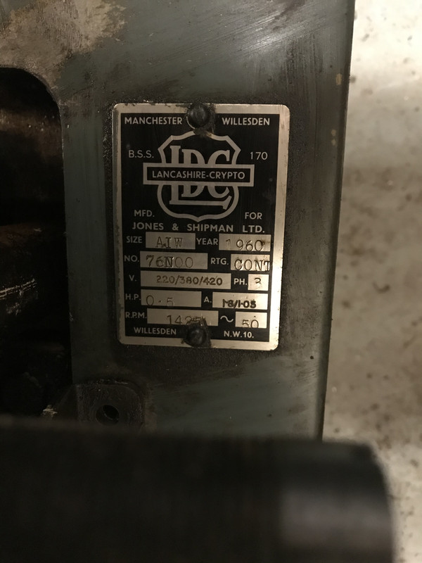

The hydraulic tank is a chain drive unit, made in 1960 according to the build plate in the tank cover
I presume the machine is the same age.

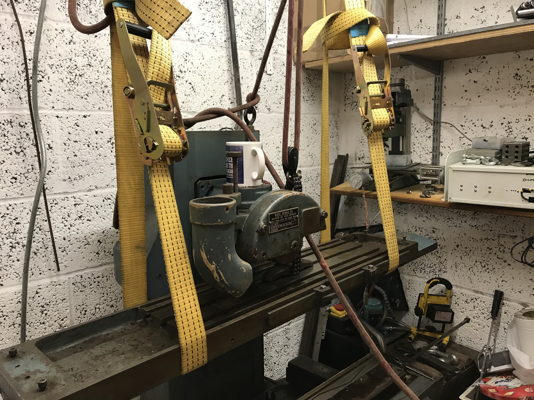

Just back from the garage
lifted the table with a little help from a block and tackle.
The oil is there, and coming out into the ways.
I ran the pistons back and forth a bit and plenty seems to come out.

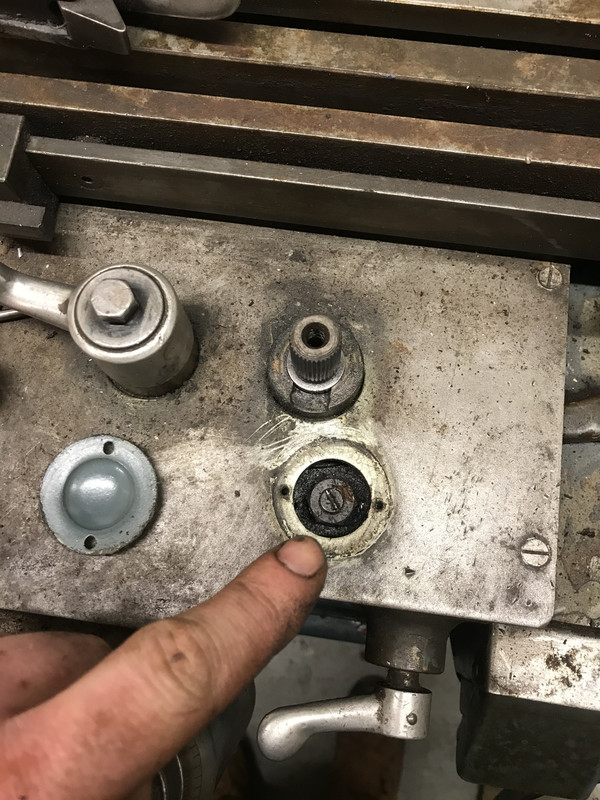

Forgot to add:
There is a dome cover on the front of the valve block:
With a thing under it.
Looks like an adjuster for something - I have left well alone but does anyone know what it’s for?
i did wonder if it was to do with the amount of way lube
David George 124/04/2020 22:03:33
avatar
2110 forum posts
565 photos
Hi Dave that is the adjuster for the traverse and hydraulic pressure just best left alone till you know it needs adjusting. I think the lubrication is adjusted by small valves inside the column under the bed. I believe the auto oiler is for the column and vertical lead screw there may be a small pipe with a tray to catch the old oil. Some spares are avilabke from Andmar. https://www.andmar.co.uk/ check the chain and gear on the pump and also the tank has a tendency to corrode by coolant getting into the oil and sitting under the oil. If the cylinder rods are badly bent don't file just remove the the cylinder and rods and straighten with soft mallet etc. If not repairable you can buy chromed rod to replace them. Also if you strip them check the seals for wear, they are available not to expensive.

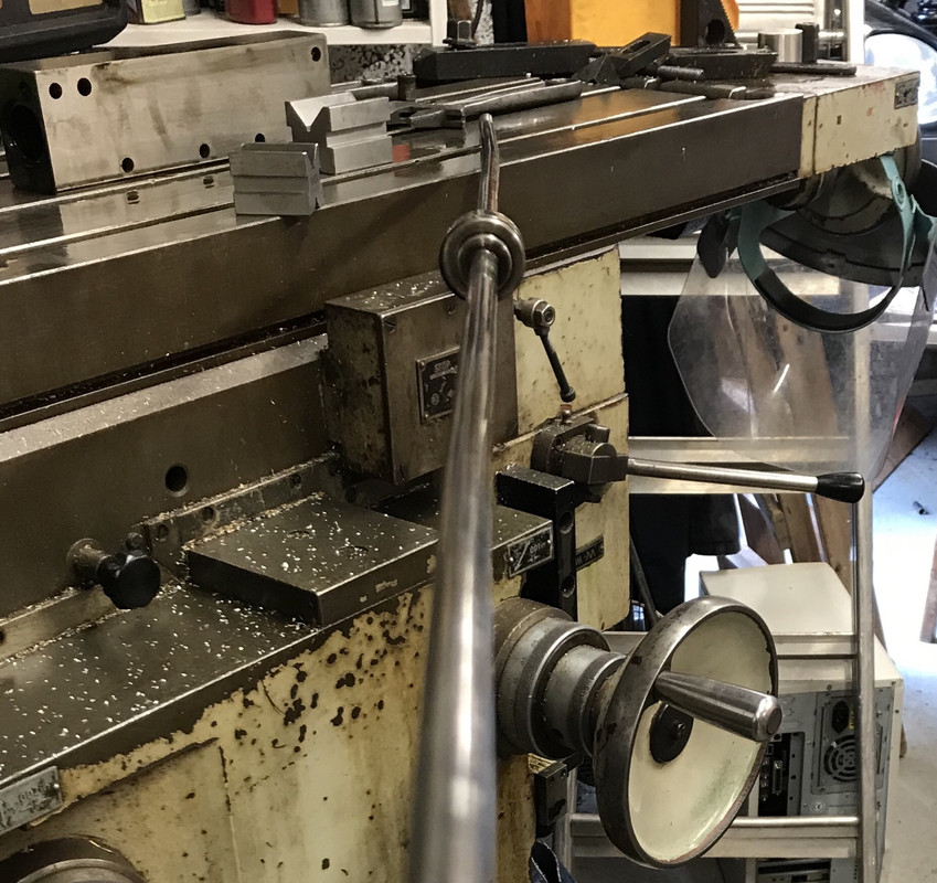

I lifted the table again to remove the rods and straighten them.
After lifting this time I used a couple of hefty ratchet straps to secure the table up and as out of the way as I could..
I put the machine in a corner and built around it, so in the current environment I can't get the table away from the machine - no helpers and its to heavy to manage on my own.

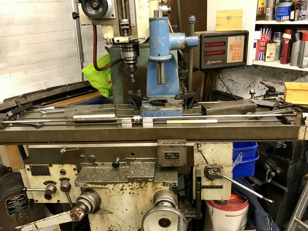

Then I removed the piston assembly. I tried to take a photo of how bent the rods were:
There was a sort of S bend in one and a single bend in the other.
Ideally I have a large surface table, of course its buried under a load of car parts at the moment.
Fortunately my Mill is somewhat oversized, so its table stood in as bench and inspection area.
Carefully using some V Blocks and an arbour press I have successfully straightened the rods. It all went back togetther ok. Ran out of time at that point, so I'll run it this evening and check for leaks, but it wasn't leaking before, so I expect it'll be ok.

My hydraulic tank has a build plate from the Lancashire Crypo Mfd, for Jones and Shipman.
