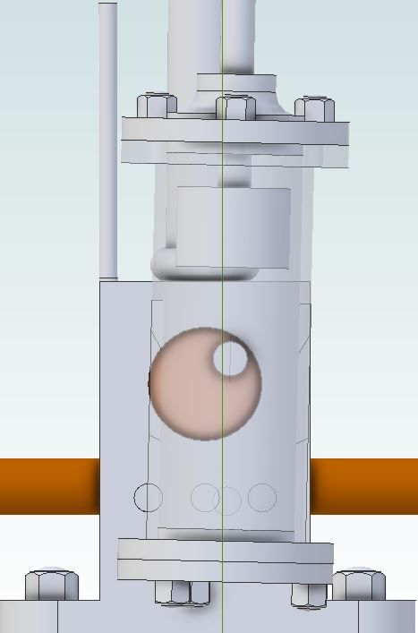

Before going on with the build I'll explain a bit about the reverser as the parts for that are the next to be made.
As I mentioned I recently repaired a Mamod traction engine for someone and got the idea from the reverse lever fitted to them which is simply a pressed steel lever that rotates and has an eccentric hole for the cylinder pivot.
There are three ports on the base, a central one that is the inlet with the ones either side acting as exhausts. As the cylinders pivot point is moved from one side to the other it will use two of the three holes depending on what side of ctr it is.
So with the lever down the pivot moves towards the right when viewed from the back.
Looking at the front you can see that the cylinder will oscillate between the left exhaust and central inlet.
If the lever is now moved upwards so that the pivot is now on the opposite side
Which means that the cylinder is now oscillating between the right hand exhaust and central inlet, this has the effect of making the upward power stroke take place when the crank is on the other side of centre thus reversing the direction in which the flywheel rotates. An added bonus of this arrangement is that with the lever placed somewhere between these two extreams the amount of time that the ports are open for is altered so the reverser can also be used to control speed and or save air/steam.

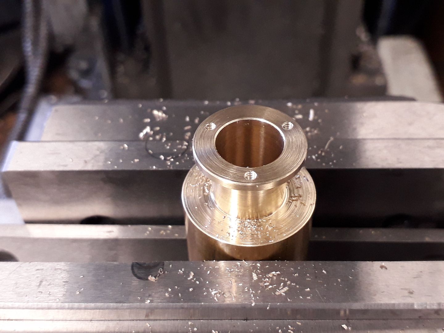

The cylinder can be cut from 25mm or 1" stock without the need to offset the bore. Start by facing off and then reduce the end to 20mm diameter followed by turning the 14mm outside diameter with a parting tool down to where the top of the port face comes. While still in the lathe drill and then bore to the finished 12mm dia.
The part face can then be milled flat and while in the vice drill the inlet hole 2.5mm, tap M3 for the pivot pin taking great care not to let the tip of the drill go deeper than 3.5mm then finally add the vent hole just below the flange. The port face can be lightly rubbed onto some 1000g wet and dry laid on a flat surface to remove any slight raised material around the holes this also keeps the edge of the inlet hole nice and crisp stop air bleeding between ports if there is any chamfer to the edge.
With the port face against the fixed jaw the three tapped holes can be orientated easily.
Mill the two sides of the cylinder flat and then slip a piece of rod through the bore and rest that on the top of the vice jaws and take a series of cuts rotating the work about 5degrees between each cut which will give the curved surface as a series of facets.
Which can easily be blended with a file and finished with Emery cloth.

The cylinder top cover helps guide the piston rod so turn the 1mm deep spigot and ream the hole at the same setting. Then transfer the work to the mill so that the three holes can be drilled while you have plenty to hold.
Then saw off from the bar and turn the external profile, if you like this can be a simple straight spigot 7mm dia but the curve looks a bit nicer and more like a casting when painted and the ring around the edge left bare.
Bottom Flange
The bottom flange can be made in much the same way but with threaded holes and is fitted to the end of the cylinder with Loctite, 648 if you intend to run on steam.
Bottom Cover
The bottom cover is just a dummy and made like the two items above. You could omit this part if you wanted in which case don't bother to drill and tap the bottom flange.
