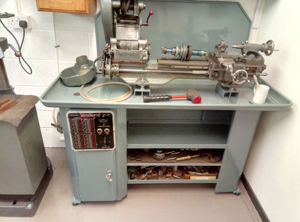

I recently purchased a Myford Industrial cabinet (version for a Long bed), however when I retrieved my 1948 ML7 from my parents house to put on it it became apparent that it's worn out and needs quite a bit spent on it. Therefore I am considering buying another lathe as it's probably more cost effective than reconditioning it.
As Super 7's are beyond my budget at the moment does anyone have any experience of fitting other makes of bench lathes ideally with a larger swing on to this cabinet?
Could do with obtaining an understanding what has worked for someone previously, I am 6' tall so can cope with it being a bit higher. Otherwise I will needs to consider selling on the cabinet but I am reluctant as I have repainted it.

Height is not a problem. Just fit raising blocks in the form of heavy-wall square tubing between cabinet and lathe as needed. Or blocks under the feet of the cabinet.
Length of a Myford longbed should accommodate any of the Chinese lathes with a similar swing and centre distance. Their sellers' websites usually have all the specs posted. The popular Sieg SC4 should drop on there with room to spare at 1 metre overall length. You might even be able to go a bit bigger if you shop around.

Robert Bailey 119/11/2019 21:05:56
8 forum posts
2 photos
Thanks for the advice so far. Lots to think about.
Below is a picture of the cabinet with the ML7 on it.
The flat area of the tray is 4'4" * 17" In this space I have 5' * 2'8" that could be used if some of the lathe were to overhang. The person I bought it of did say they had had a Raglen on it but I am not sure I would get on with one.
As can also be seen I begun to investigating reconditioning it. When turning my test piece to finish setting the leveling jacks at the back it was 0.1 mm out over 125 mm there was also chatter and 0.1 mm movement in the headstock. So I abandoned the leveling and blued up the bearings with a view to scraping them. Also got a quote for a new hardened spindle and bronze bearings at £325 if it does now work. As its a 1948 machine and could also do with a bed regrind I started to explore the options of what else would fit on the stand, possibly a larger machine.

Whatever you mount on the stand, do allow space behind the Headstock for material passed through the Mandrel to hang out the back. without fouling the other machine
Also allow just enough room to remove the Tailstock, if you ever need to do so for any reason. It would be pretty galling, having once levelled the machine to have to undo all that work because the Tailstock needed removing for some reason!

It looks in better shape than my ML7 before I refurbed it.
Have you measured the actual bed wear? Myford allows up to five thou on the top of the way before it's considered worn out.
And three thou on the vertical rear face of the front way, the one that takes most load. However, you can get around this on a 1948 model by doing a wide guide conversion, as described in detail in the current issue of MEW. Its a simple job.And no need for a regrind.
Headstock bearings might just need a couple of layers peeling off the shim packs that go between the bearing halves.

To look at its ok, Its being in a pretty dry workshop for the last 20 years, that's why I was optimistic about using it again I , just conscious its something that i could be easy spend more than its worth improving.
Yes the worst place its 6 thou but some of the surfaces are a lot better so I think I will try the wide guide conversion.
With the white metal bearings its about the only subject I cannot find a comprehensive video on you tube about. Putting all the info I have looked at together I am inclined to rub the flat faces of the shells so they grip the shaft, blue them up and scrape down the high spots, ensure they still just grip the shaft. Then bolt them back down with a few less shims so it rotates freely with around 2 thou of movement. Previously there was a mixture of all sorts of bits of shims so presumably its best to have the same thickness on both ends of the cap?

You shouldn't need to file or sand the flat faces of the shells. Usually those faces are separated by shims. Usually those Myford shims are actually stacks of thin aluminium foil that can be peeled off layer by layer. Each layer is about 2 thou thick. So if you have 0.1mm up and down movement, you might try peeling off two layers from each side.
If yours does not have the aluminium foil stack type shims, you can either buy them from Myford's website or just make your own solid shims from shim stock in whatever size is needed.
It is common practice for shims to be thicker on one side of than the other. It's a way of getting one thou of adjustment, roughly, by removing a two thou foil layer on one side only.
YOu can leave the shims out when doing the bluing and just use light pressure on the bolts to make shell contact shaft.
Most of the time they do not need scraping, just the shims reducing.
There will eventually be an article in MEW on scraping the bearings, but couild be some time away as there is another article on completing the wide guide conversion to come first and they seem to run every second month.
