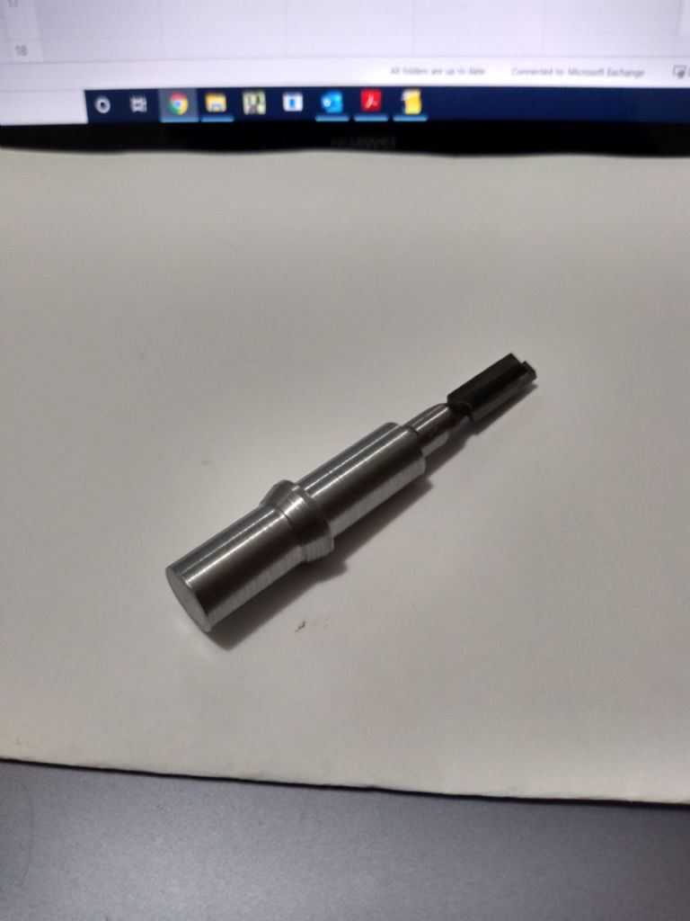

Thanks for the suggestions folks. After a bit more thought I realised that actually I could make a stronger extension by making it to fit in the spindle instead of a collet. The standard Trend collet is 10mm dia opening out to 12.7 mm at the taper, while the hole in the closer nut is 10mm. I could therefore make an extension 10 mm diameter with a tapered collar to engage with the taper in the spindle. So that leads on to another question:
Does anyone know what the taper angle is on the Trend collets please??

John Haine15/11/2019 10:11:11
5563 forum posts
322 photos
This is what it looks like...
John Haine15/11/2019 18:31:09
5563 forum posts
322 photos
And this is the adaptor I just turned up from 1/2" silver steel rod.
Cutter not yet loctited in.
John Haine16/11/2019 10:14:20
5563 forum posts
322 photos
Loctited in the cutter last night. Mounted extension+cutter in router this morning and spun up to max speed, no perceptible increase in vibration. We'll see how it performs for cutting.
