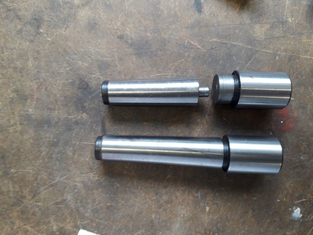

JasonB16/09/2019 13:30:15
avatar
25215 forum posts
3105 photos
1 articles
A virgin MT2 and one that is not, as said carbide and a reasonable size lathe was OK, not sure how the Cowells will cope. part of teh taper needed turning down so only the small 1/4" dia spigot remained so the taper would sit just below the level of my rotary table

That one I showed was held in the 4-jaw by the blank end, clocked true and tailstock support used while the middle was turned down to 1/4" dia. I then sawed through the 1/4" and filed the end to finish.
Will depend what you are making as you could not do say a dead ctr that way but you could certainly rough most of it out and then just take a finish skim with it in the Cowells spindle.
