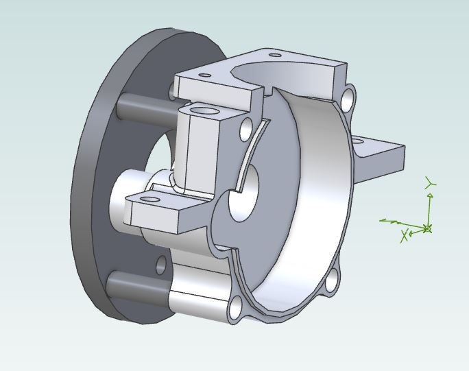

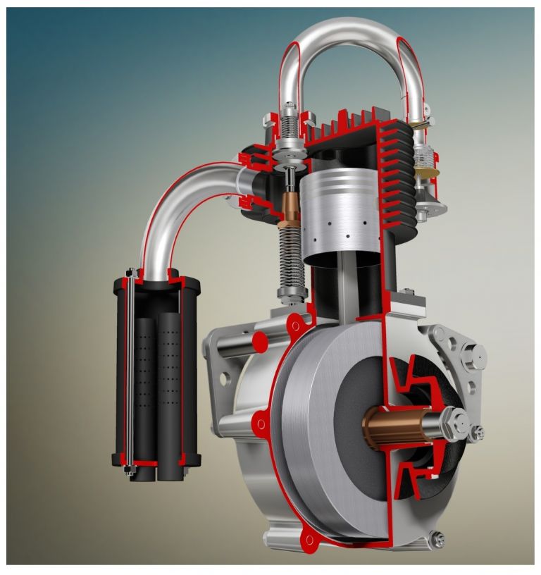

I have been scratching my head for a while now so I thought I would come and ask the experts...
I am planning on building an engine, the original plans of which can be found here:
https://archive.org/details/motorbicyclebuil00hasliala/page/66
I am concerned that if I purchase a Myford 7 lathe then I will be exceeding the Myford's maximum capacity.
The engine crankcase measures roughly 9" in diameter by 2" in depth.
Does anybody have any practical knowledge as to what I can safely squeeze in without resorting to a homemade spindle raiser?

I'm not really a Myford man but think the part will be too deep for teh gap particularly the half with the timing gear case which will push it away from a faceplate. You may just get away with diameter but would need to work out what the radius is to the corner of teh cylinder flange.
Is it going in a bike? if not you could scale it down to a more manageable size or I have seen similar early bike engine crankcases done as welded fabrications.

Andy, do you have a milling machine as the crankcase halves could be machined on that as well as cutting the lip and recess around the joint with the aid of a rotary table. A boring head would take care of the bearing holes
Are you proposing to use castings or cut the crankcase halves from solid?

I am in the process of sorting out the CAD I have developed to create patterns that will be 3D printed for sand casting. .
I am afraid that I don't have a milling machine hence my attempt at trying to get the parts to fit on a face plate somehow...

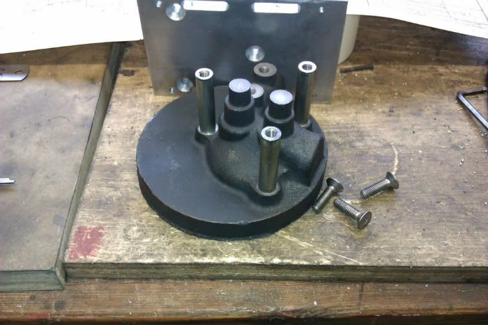

As I hinted to earlier the crankcase halves are not too difficult to hold and you don't need any large faceplates or chuck to be able to hole them.
The trick is to first tap the bolt holes and then with the use of stand-offs the casting can be screwed to a machining plate or disc that is in turn tapped to suit the spacing of your faceplate slots. Something like this would fit a 7" faceplate and 8"+ part, the central hole in the plate could even be made large enough to accommodate the bearing housing to keep projection as small as possible.

Similar setup on this cylinder head to allow for the rocker arm post
