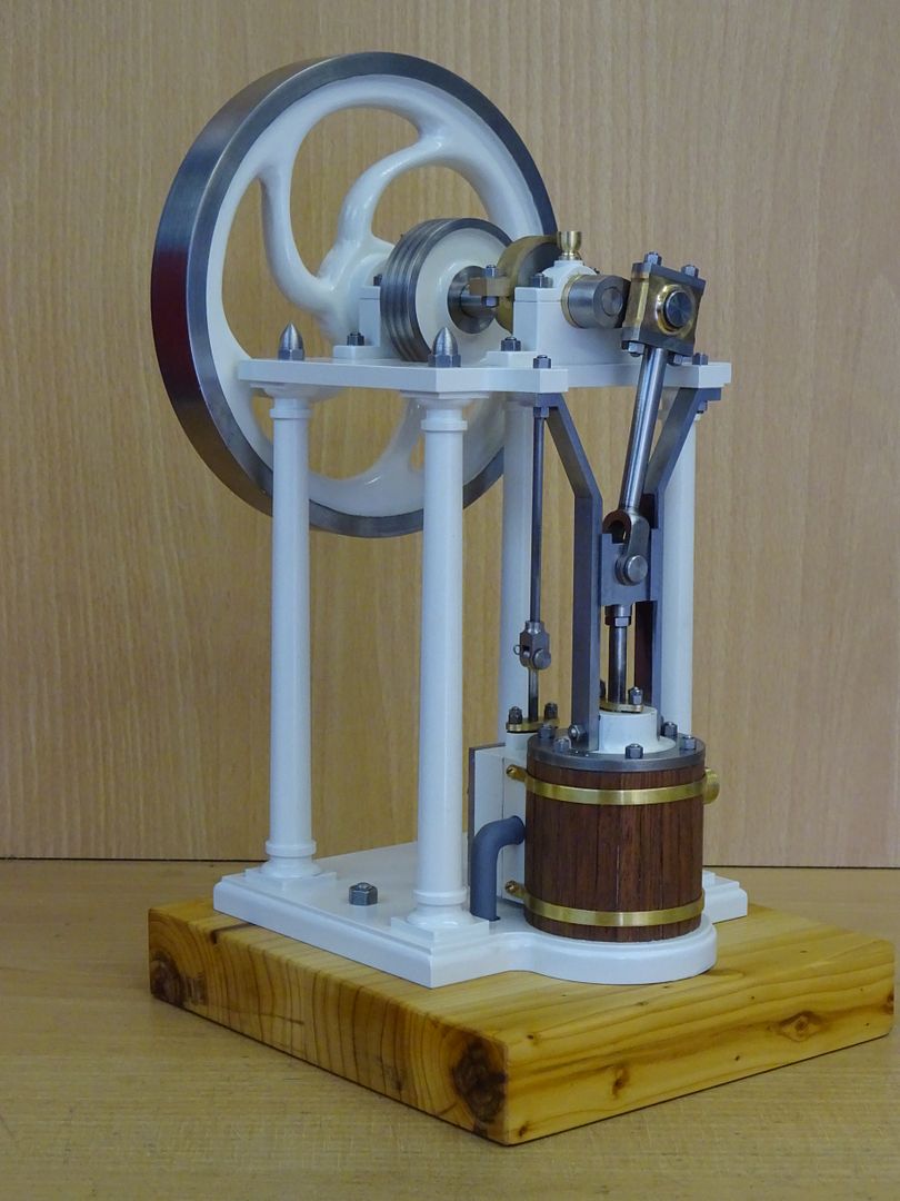

geoff walker 131/07/2019 10:50:11
521 forum posts
217 photos
Hi All,
Well, it's all finished, painted, lacquered, etc. or as Jason would say "tarted up".
The base is an oak lap jointed frame with a briwax finish.
The baseplate is heavy, 150 x 100 x 10mm M.S. plate sprayed with a hycote primer and then lacquered to finish.
The frame, valve block, bearing blocks etc. are primed then two coats of halfords industrial grey enamel and again lacquered to finish.
The flywheel is hand painted with a humbrol primer and enamel.
Video of it running is on you tube, search Bobbie jones muncaster double acting oscillator. Seems to be running really well, good balance.
Hope it's of interest Geoff

My version of the vertical cross; similar to Muncaster apart from cross head arrangement, from Stu Harts design...
George.

A very good looking engine, Geoff. Nicely finished and it runs well too. I am enthused to get my current project finished and set to on the casting for this engine you kindly sent me.
Jim

That turned out nicely Geoff, I've added the video to your post.
