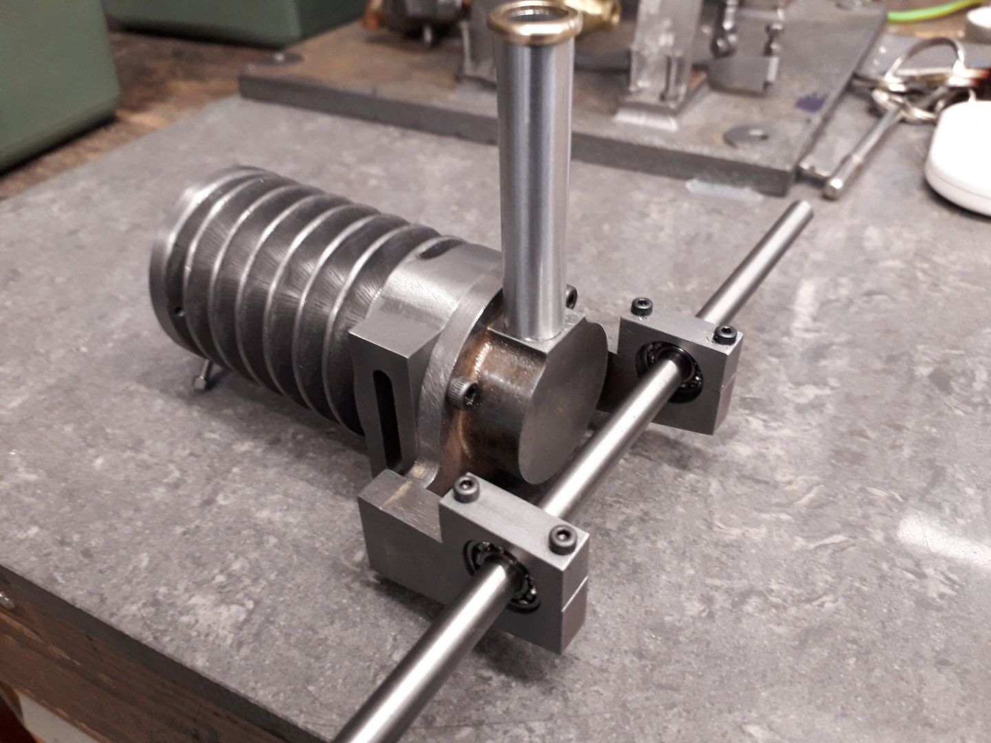

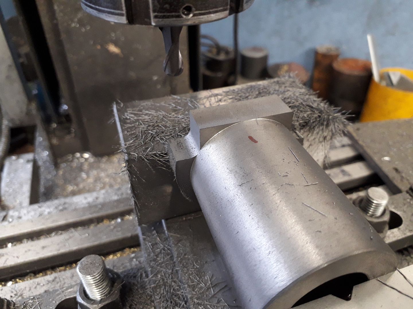

The cylinder started out in much the same way as the Chuky with the ctr mark of the bore in the 50mm cast iron bar set to run true.
It was then faced, bored and a small spigot added to locate the cylinder head.
Reversed in the chuck the OD of the finned area was turned round and the end gently faced once the tailstock support had been removed.
Over to the mill and the port face was machined flat
Then to width
Followed by milling the port, this was sized for the flame licker version but could have been a lot smaller for the air/steam engine. I also had to subsequently drill and tap two M2.5 hols for the new valve block.
With a change to the horizontally mounted rotary table the rest of the lower part of the cylinder was milled round.
Now for the fun part of machining the spiral cooling fins. The rotary table from ARC has a 72:1 reduction so for ease of machining I opted for a 7.2mm pitch spiral which meant that for every turn of the hand wheel the milll table would need to move 0.1mm, as this was a bit coarse I opted for half a turn of the handle and 0.05mm x-axis feed per plunge cut of a 5.5mm 3-flute cutter. The two ends of the spiral were feathered out further with a 3.0mm cutter.
Just over 1000 plus plunge cuts later this is what I ended up with.
This picture shows the machining marks left by the plunge cuts which were cleaned up with a file and the whole "casting" given a once over with the Dremel to give it that cast look.
I think it could do with some legs next

I like the cylinder, did you try screw cutting it first or was the milling the first option?
B
JasonB12/06/2019 20:15:15
avatar
25215 forum posts
3105 photos
1 articles
Did not consider screwcutting as I woud not have been able to start and stop without run in/out grooves and approx 3.5TPI is beyond my machine.
I did briefly consider mounting my old Unimat 3 mill column on the lathe cross slide but by the time I had done that and sorted out gears and a leadscrew drive the mill was the easier option.
Ron Laden13/06/2019 09:00:50
avatar
2320 forum posts
452 photos
Posted by JasonB on 12/06/2019 19:36:15:
Jason, you must have the patience of a Saint, over 1000 plunge cuts...surprise you should be awarded a medal for that..smiley
Nigel Graham 213/06/2019 12:56:52
3293 forum posts
112 photos
Superb work - challenging too, and I noticed something I suspect many of us (mea culpa!) overlook - close attention to cutter and tap types best suited to operation and material.
I'm a bit puzzled: You did not link the table travel to rotation, for what is effectively thread-milling, by gearing or digital control? So all by manual travel / angle setting? If so, as Ron says, the patience of a saint!
I recall some years ago an ME contributor saying faced with an equally repetitive operation, thinking it best he did just a few increments a day to keep up the standard. He was filing the triangular ports in locomotive piston-valve liners, where obviously the lengthways extremities matter. He told us he would get up a bit earlier in the morning and file two or thee of the already-drilled holes before going to work, leaving the next two or three till next day. After all, there was plenty of other work on the project for the evenings.
JasonB13/06/2019 13:20:25
avatar
25215 forum posts
3105 photos
1 articles
Ron you may just be able to see my hitec depth stop at the top of the photo, that did help a bit.
Nigel, My mill does not have the facility to gear the table movement to the dividing which would have been another way to do it. I did consider putting my old Unimat3 milling column on the lathe carrage and setting up to "screwcut" but I would have needed to buy or make extra gears and probably drive the leadscrew as the 3.5tpi pitch is too coarse.
I have since got a CNC mill which with the addition of a 4th axis would have been an ideal way to cut the spiral and the basic machine would be what I would use now to machine the baseplate. Luckily I am able to draw the parts in 3D which is the starting point for CAMwink 2

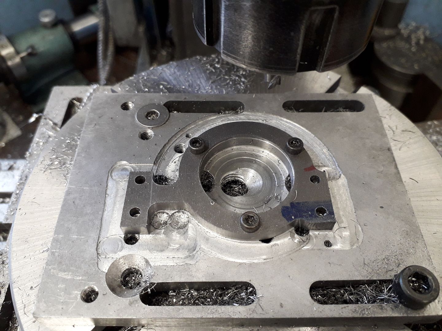

The "cylinder head" which incorporates the bearing supports started life as a piece of 5mm plate which was marked out and the bigger bits of waste material roughly sawn off. This was then clamped to a scrap of aluminium on the rotary table for drilling the various small holes and some to define the internal corners. Three of the holes were carried on at tapping size into the ali plate and then tapped so some additional screws could be used to hold the part while the main hole was bored.
The two clamps were then removed and the outside milled to shape.
The flame licker design needed a chamber for the spring and valve, this was bored out on the lathe and then transferred to the mill to shape the outside leaving a flat area into which the exhaust stack would screw.
Jumping forwards a bit the parts including two bearing supports have been silver soldered together, bearing caps screwed on and the assembly mounted back onto the ali plate to bore first the top bearing hole.
And then the other, in both cases the bearing was used to gauge the size of the hole
Hard to resist a quick trial fit
A bit of milling and the bearing caps start to take shape
Then roughing out the curved top which was finished off with a file
Final bit of machining was to drill and tap two radial holes for the legs to fix to.
A quick talking to with a grinding point in the Dremel knocked off all the hard corners and added a bit of texture to get the cast look.

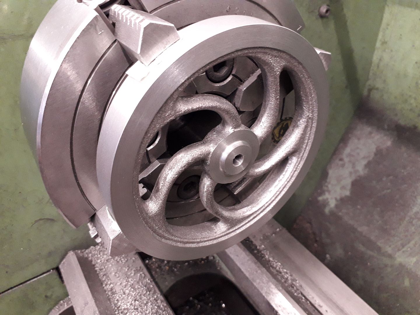

Another curved spoke flywheel casting the same as I used on the Muncaster Entablature engine was soon machined up to a firm push fit on the crankshaft.
Time for a quick play to see how the bearings from ARC run, i can't really complain about this.
