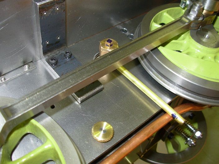

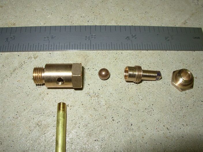

Here's the parts for a complete valve of this style:
Here it is installed:
If you add an O ring on the valve spindle just under the retaining nut, you will not get any steam blowing out around the spindle when you blow down. Just make sure you open the valve enough to squeeze the O ring.
Peter Krogh09/06/2019 03:05:00
avatar
228 forum posts
20 photos
Don't drill for the exhaust until you've screwed it into place and marked which way it should point. No shimming to get the thing clocked.
