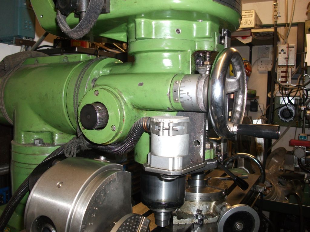

John P06/06/2019 11:25:22
451 forum posts
268 photos
The Z axis stepper motor drives the quill on the machine ,only a small
stepper motor was used have no details on this as it was a scrap box
part.The motor was mounted to keep within the profile of the head so
the head can still be if needed tilted 90 deg without fouling.
The lead screw seen here fits in place of the drill depth stop screw
and nut assembly which was useless item anyway,the nut has some anti
backlash adjustments.
The original block for the drill stop is replaced by a T shaped part that
has a horizontal dovetail and fixes to the quill using the same 2 holes,
a split clamp slides apart on the dovetail,when required for cnc operation
the clamp is positioned around the nut and secured with 2 m4 screws.
Two more photo's first one showing the underside of the table powerdrive,
i made a bracket to fit this to the end of the table and included a geared
take off ,a clutch can disengage the drive from the lead screw so the power
take off can be used with or without the lead screw engaged.View above
the gear output from the drive,one of those things done a long time ago
that was never taken to completion ,the cnc operations make this redundant
now.
