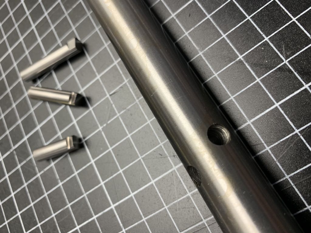

Gents,
I recently bought a boring bar from Myford. It runs between centres and I was planning to bore the cylinder on our Stuart steam engine with it. It comes with some tiny cutters but I am not sure how it works. The bar itself has 2 holes drilled (both smooth, no threads in either) and these 2 holes are perpendicular to each other. The cutters fit very nicely in the holes with no discernable play but slide in and out without much effort.
My question is how are the cutters fixed in the bar?

Usually the holes would intersect, and one of them would be tapped for a grubscrew. That is how it works on the ones I have inherited and made anyway.

Hi yes the cutter is clamped by a grub screw in the other hole which overlaps the cutter hole. You can set the cutter diameter by using a dial test indicator datum set on the boring bar and winding out the difference to set the bore diameter.

The 2 holes should just intersect each other .
One of those pieces of tool steel should then have a flat on the side.
This is used to act as a wedge against the cutting tool in the adjacent hole !
I have one the same and don't really like it as i find it difficult to adjust finely, its much easier to adjust and clamp with a couple of screws

TB is right. I have one of these and one hole holds the cutter while the other has piece that is flatted on one side in a slight taper. The cutter is wedged in place quite firmly but adjustment is tricky.

Presumably, one of the OP's "cutters" was a wedge. An easy mistake to make and one easily avoided by the seller.

Is the wedge in fact a taper pin and does it project from the bar? If so, this seems another disadvantage to this design as it will constrain the projection of the cutter - the bit that matters!

No, it is not faulty.

Hello Chris, thanks for pointing out that the bar is not faulty. I didn't realise that the cutter was secured by a wedge. That makes it even more difficult to adjust, unless you know of a good way. I would not give such a boring bar house room. The micrometer type is much, much better.
