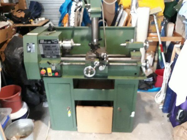

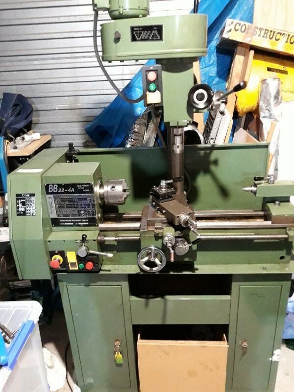

Hi All, the Lath Mill combo is a BB 22A Cutting Machine made by Beike Machine Tool Factory.e.jpg

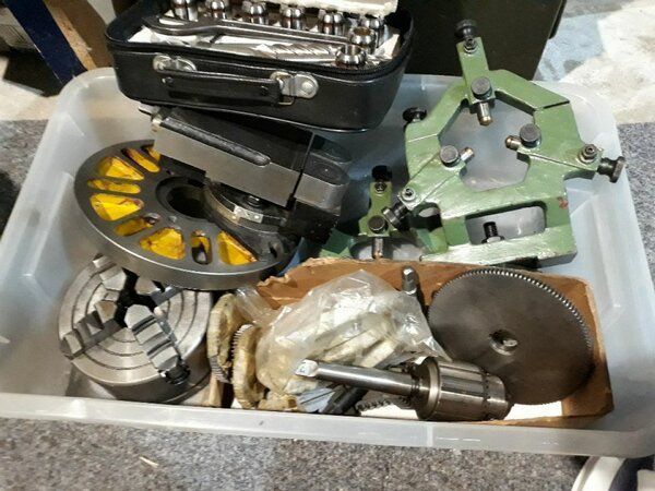

This is the box of parts that came with it a Collet set, 4 jaw chuck, faceplate 2 steadies, changewheels, tailstock drill chuck and spare jaws for the 3 jaw.

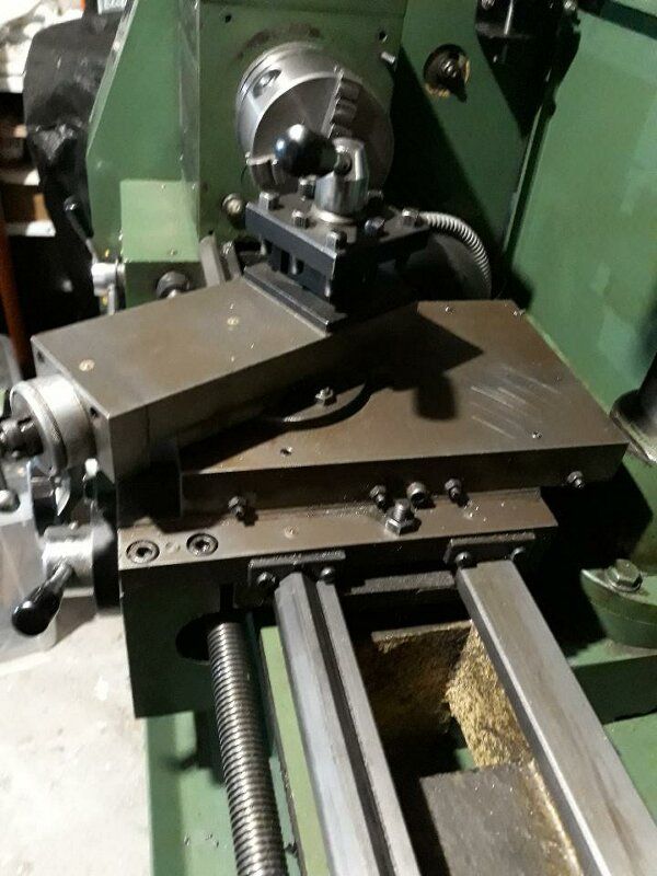

I bought a set of 12mm tools and that's whats in the second picture but it was still leaving a little nob on the end. Bought a whole series of Workshop practice books and nothing talks about getting the tool to match the centre or how to set up the mill on a lathe set. Most talk about verticle vices and milling with the lathe.

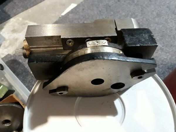

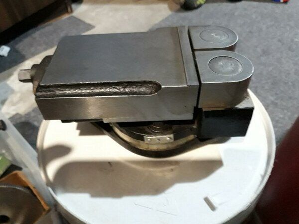

The bottom flat part rotates and there appears to be two tee bolts inside it, viewed through the outside hole on the bottom when rotated.

Owen, probably worth removing the top slide -- the one with the 4-way tool box on it and post a photo of the cross slide then we can see what's there, it does look as though a sub table will be needed

That's a machine vice! It may or may not be designed for the lathe, if you take the topslide off and compare you may find that the vice will bolt down instead.
A slotted table may well be more useful than a vice as it gives more ways to clamp down the work. That one from ARC looks quite useful. Myford ones will generally be used now as I don't think they are in current production.

Posted by Owen S on 28/04/2019 10:36:18:
That's your missing milling vice. If you turn that square shaft sticking out the left hand end in the pic, the moveable jaw will open. The fixed jaw appears to be a two-piece type than can grip either straight/square jobs, round jobs or odd shaped jobs as the two parts of the fixed jaw pivot.
The base appears to be made so it can bolt to a T-slotted plate that would be bolted on to the cross slide once the top slide has been removed. The two small half-rounded blocks on the base drop into the T slot. Then two T-bolts stick up from the table through the slots in the vice and then two nuts are tightened down on top to hold the vice firm.
I'm sure I have seen T-slotted plates for sale somewhere, maybe one of the suppliers that advertise on this site? That would be cheaper than a Myford cross slide jury rigged up.
The graduated dial above the vice base is to swivel it so you can mill at an angle or do simple dividing such as drilling a circle of six holes in a flange etc.

It looks like a Clone of an EMCO Maximat 11. You do indeed need a sub plate for doing work with the Millinghead. I have seen these for sale from tool suppliers,
