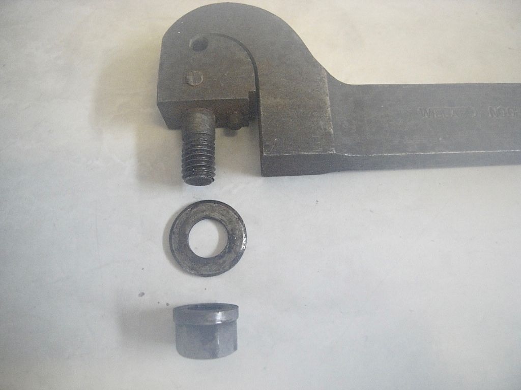

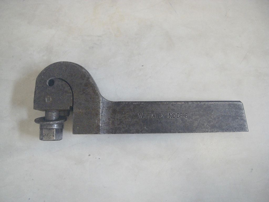

Hello all,
I am seeking information about a swan-neck tool-holder I have acquired.
It is marked "Willard NO.OF-S" and is 7" overall length, 2 ½" deep at the cutting end and ¾" thick.
As can be seen in the images,the method of securing a replaceable tool 'tip' is different from most others.
I have looked under references to USA-made Willard lathes, which seemed to be in their heyday around the 1920's, but have been unable to find anything remotely like this tool holder.
If anyone out there has any information I should be very interested to know what size and shape of cutter is carried by this holder.
I don't think I'll use it on my SB Heavy 10, but would like to try it out on my shaper and benefit from the swan-neck configuration.
Regards,
Brian

Thanks Michael,
That's an interesting tool you discovered and seems to verify the period I had in mind.
Another reply received from the USA suggested that mine used a circular cutter, like a fat washer, which may point to it being used for finishing cuts on flat surfaces.
Regards,
Brian

Thanks Martin & John for your contributions,
It's a bit like a No. 19 bus - you wait for ages then two or more come along. I've been looking for a while and found very little on the Willard range of lathe tooling until I posted my enquiry - now eBay and other sites seem to feature variations on the one iI've got. I haven't yet been able to identify the exact style of cutter that the tool held, but live in hope.
Brian

If the swan neck spring effect is to be in the correct orientation the tool needs to bolt up from underneath. Which means a fairly shallow tool with a pair of round holes. Large for the stud, small for the pin. Which seems both illogical and expensive.
Make more sense if there is another part that bolts onto it to actually carry the tool. Guide pin would ensure consistent location. But that really only kicks problem a bit further down the road because we still don't know what the tool was like.
Wild guess is a sort of quick change swan neck tool system. Its American so would probably be used in the abominable lantern type tool-post with its inherent lack of rigidity and essential impossibility of interchanging tools without loosing the setting. In principle tools in simple holders could be set up once and changed as required by simply undoing the nut without resetting.
Like Martin I first thought of the once popular form threading tools, I have a bunch of SKF-Johansson-Dormer ones and they are great. The holders even have a similar split configuration with a screw for fine adjustment. But the Willard tool puts the swan neck flex in line with the bed rather than perpendicular to it which doesn't seem as if it would be useful.
Clive.

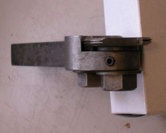

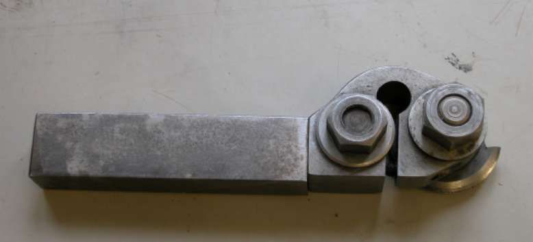

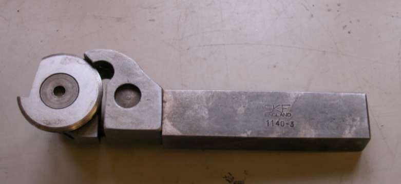

Bill
Three pictures of the very similar Johansson / SKF / Dormer system. Note the socket headed grubscrew in the front view. The left hand threaded countersunk socket head that holds the chaser in place has a flat on it for that grub screw to bear on providing extra insurance against things unscrewing.
Countersunk screw appears to have a non standard angle on the head making it shallower. Whole head can be twisted on the shank to match thread helix angle and locked using the second nut. As can be seen in first picture the standard chasers have two cutting points to generate full form for each pitch so setting helix correctly is important with coarser threads.
Just visible in the last picture is a screw used for fine adjustment of cutting height buy springing the swan neck.
I have a good selection of UNF and Whitworth form pitches but no metric. Does anyone know where metric ones can be got from?
Clive

Clive & Bill,
That was an interesting diversion and confirms that an understanding of Geometry, particularly tangents, can be of help in engineering !
Those images look similar Bill, which narrows the field a bit, but I've yet to find one marked 'OF-S' and determine the shape of the actual cutter - so the hunt continues.
Thanks for the contributions chaps.
Brian
