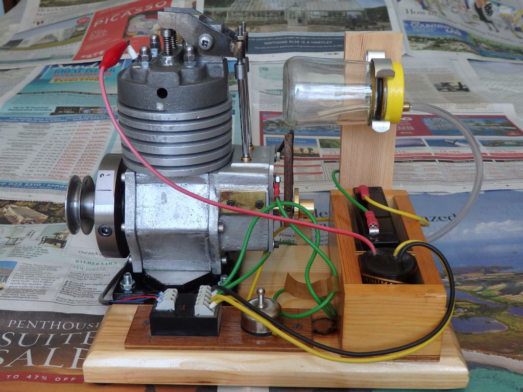

Hi Howard - Yes, I have a copper tank that could be used though I like to see what is going on with petrol levels. Wished to add a picture of the problem engine for general inteterest but did not succeed. I see MichaelR managed with his photo.

Problem engine, thanks JasonB for photo guide input, quite a bit of time for the result to appear.
David standing - canon/cannon that really provoked more than a smile a real laugh!
Will be pressing on with a vapour bottle, the photo shows petrol supply to a Nemett carb. on the other side.
Patrick Cubbon.
