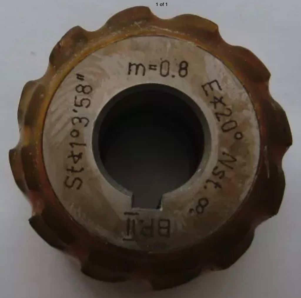

I have a need [desire] to make MOD_0.8 gears, probably from aluminium alloy, in a wide range of tooth-counts.
A small self-contained machine would be ideal, but I want to avoid the complexity of a 'versatile' device like the Jacobs. This will be using one hob [which has already been ordered] and only 'straight cut' spur gears are required.
... Stepper Motor controlled would be of particular interest.
Does anyone know of a suitable design, or have any ideas, please ?
>>> note: I have already decided against 3D printing them

The 'obvious' solution to me is something that senses cutter rotation and synchronises to a stepper motor driven spindle carrying the blank.

In MEW a while back there was a design for exactly this. It needs a high count encoder on the mill spindle to generate pulses that are divided down to drive the stepper that rotates the gear blank. I seem to recall that Sir John also had some ideas on this.
This is something that I've been contemplating to use with my digital dividing head conversion. Failing a high count encoder (which is expensive and tricky to add to the spindle), a better approach IMHO would be a one pulse per rev encoder and a phase-locked loop to multiply the spindle speed up so you set the division ratios using two dividers, one in the PLL and the other dividing down the PLL's VCO to drive the stepper. I've even got as far as buying the program switches! I think it should be doable with a few CMOS dividers and a 4046 PLL chip.

Joe having put my activity on the board I must now comment- I had built a Jacobs machine some 20 years ago but found the changing of gears for each wanted gear a bit of a fag, just the same as setting up for screw cutting on the lathe. The lathe problem was solved by Joe giving me the detail and lots of encouragement for an ELS (electronic leadscrew).
This was such a success that I asked Joe for an opinion on removing all the gears from the hobber and doing the same electronically, almost by return he had produced a program and circuit.
It was then down to me to make a new gear blank head and set up an encoder on the hob spindle. This is still work in progress (work being impossible for the last 2 months, too hot). Without doubt if I were starting on a hobber today it would be a stripped down Jacobs with Joes electronics.

I can confirm that the CMOS phase lock loop, CMOS divider chain and digital encoder approach to synchronising two stepper driven spindles is practical and relatively easy to implement. Main gotcha is sorting the frequency response components on the phase lock loop right for stable operation. If possible switched ranges set-up is better than trying to do it all in one range.
Stable operation at better than a tenth of a step error is easily achieved, you will need to gear down. Its arguable whether two steppers and all digital control is better than one stepper slaving to one free running servo motor. I've used both but this was back in the late 1970's when CMOS logic was still the latest, greatest thing. No nice microprocessors then. Pretty sure I ended up with a dual CMOS PLL and a voltage control oscillator or two.

All was detailed by John Stevenson on one of the forums (HSM probably) and on his own website when it operated for the system he used on his milling machine for commercial gear production (for the Myford metric approximation gears). Initially using hard divider chips and later a micro when someone else wrote the software.
In essence a 20:1 dividing head plus 200 step motor requires 4000 steps per revolution. The spindle needs to generate 4000 pulses per rev. then it can be divided down to drive the stepper. As a 4k encoder is rare he used I think an 800 pulse one and a 5:1toothed belt drive speed increaser. Other combinations can be used and digital doubling or using falling/rising edges helps reduce the gearing.
If you have quadrature outputs to give a direction and the circuit can follow it you can reverse and keep in step to start a second pass, otherwise you have to have a zeroing procedure or do single pass.
TTL makes it fairly easy to do the dividing if you can get the chips. A software solution has to do integer division not just slap it into the floating point algorithm in the compiler.
I'm not sure if a digital PLL keeps accurate count as the swallow counter means it is only correct on average.
If you are using the lathe for it then once you have the encoder you can do an electronic leadscrew.
Don't forget the blank axis is not perpendicular to the hob axis.

Not forgotten, Bazyle ... In fact that was one of the triggers for me to decide to build a 'single-purpose' machine rather than a more versatile one.
The magic number, for the specific hob that I have ordered is 1° 3' 58"
I think we've made good progress on the electronics side. [thanks everyone]
I'm also interested in suggestions for the mechanical design of a stand-alone machine, that preferably fits within [say] a 12" cube.
