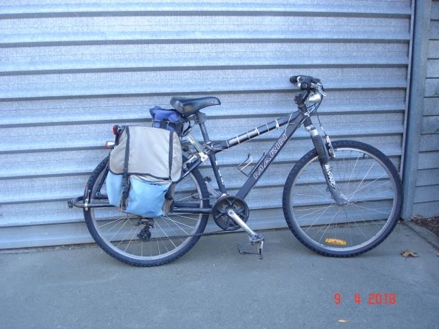

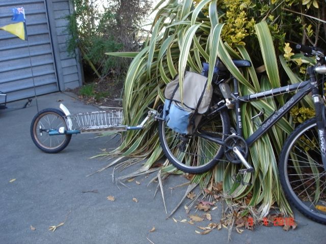

dsc01365 (640x480).jpgA better point of suspension would be further foreward on the rear axle, I'v just done this for the trailer hitch on my new bike, the hitch on my old bike was from behind the rear wheel, and as the load on the trailer went up, so did the front wheel/ well it got very light.
This is the old bike
Ian S C
