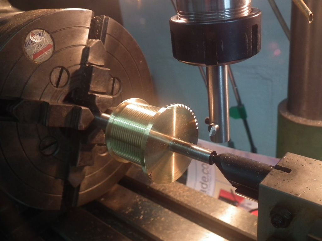

Assuming it's a normal winding ratchet like the one you linked to you can cut the ratchet teeth using a home made single point cutter but you will need some means of indexing the 14 positions. A bit like this:

You can use a single point cutter on brass and probably get away with it on steel if you use a slow speed and small diameter. You probably have a flycutter for your mill that will hold the tool bit so you can use that. Just draw out the cutter and ratchet on paper at a larger scale to plan the shape of the cutter and the position of the wheel blank.
What kind of indexing mechanism do you have? Unless you are trying to repair an antique to original standard you don't have to stick with exactly 14 teeth, 15 would do. You can use a change-wheel off your lathe to provide the divisions.

John Haine18/05/2018 07:27:19
5563 forum posts
322 photos
You would be able to cut a steel ratchet using a dovetail cutter, would need to mount the blank very firmly though. Later I'll post a photo of one I did in brass, principle is the same.

John Haine18/05/2018 20:15:38
5563 forum posts
322 photos
John Haine18/05/2018 20:17:28
5563 forum posts
322 photos
Above photo is 60 tooth wheel cut with dovetail cutter. One side of each tool is radial. This is for a Woodward Gearless Clock.
