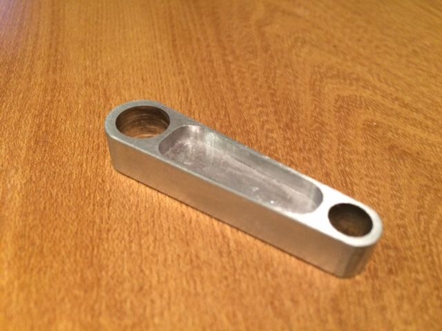

Craig Booth 101/05/2018 21:43:33
84 forum posts
165 photos

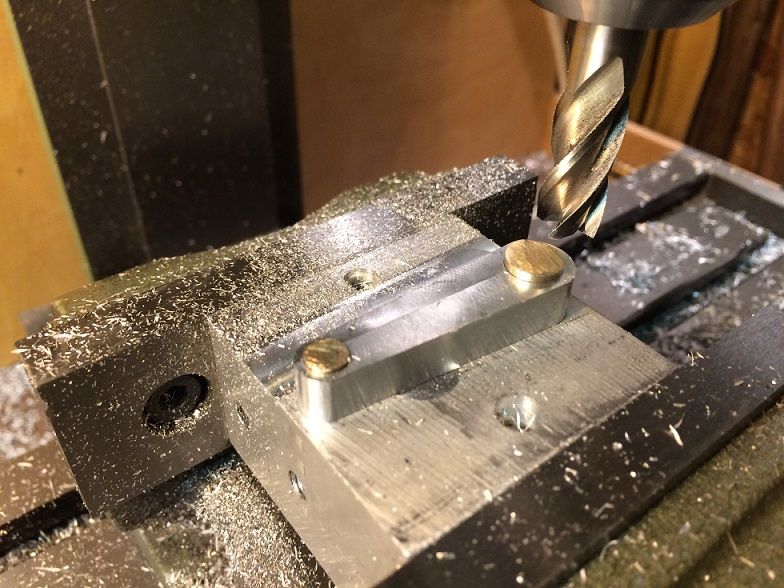

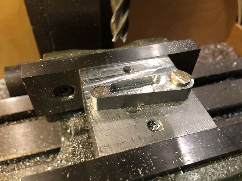

I had a small bit of material around while waiting for the stock to arrive and couldn't wait to start so got started on the crankshaft. A few pics below. Made a holding block with retaining pins set on the required taper angle and also to use to mill the external radii.
Happy with the results. Looking forward to getting to the dozens of other parts.

Craig Booth 102/05/2018 07:27:57
84 forum posts
165 photos
Thanks Jason, Thanks George,
Just realised my first mistake. Called it a crankshaft rather than conrod. i'll put it down to having a long day at work laugh

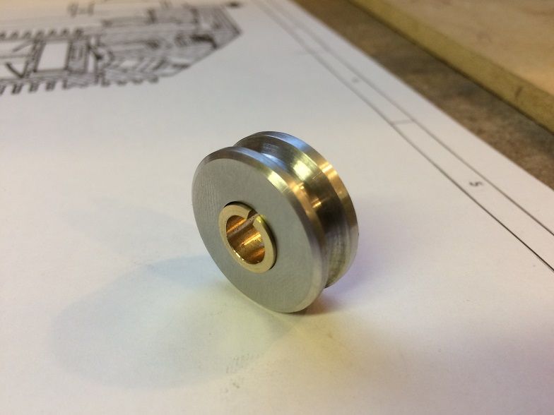

ok, here's my first question. (I'm starting on the easy bits). The plans call for a drive washer and a drive washer cone (i.e. a split tapered bush that will compress onto the crankshaft when the prop nut is tightened.
The drive washer is aluminium but there is no mention of what material the split cone should be, although it is shown on the same plan page as other aluminium parts.
My thoughts given that is going to be under compression and will receive rotational force that it needs to be steel and not aluminium. In my head I feel that two aluminium sufaces in contact like that would bind and potentially fuse.
Any opinions?
Cheers Craig
LADmachining02/05/2018 09:39:57
avatar
126 forum posts
11 photos
I have used mild steel and brass for the split taper bush in the past on various engines, with no issues.
Aluminium, I think, may cause issues, by galling and welding itself to the prop drive hub or the crankshaft itself.

JasonB02/05/2018 10:31:02
avatar
25215 forum posts
3105 photos
1 articles
I have used brass and you often see that used on commercial engines.

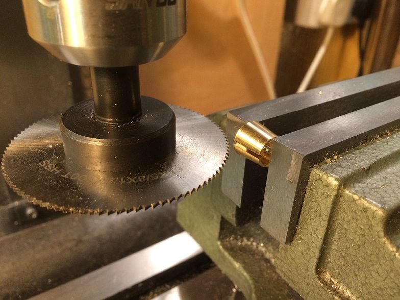

Craig Booth 102/05/2018 13:49:02
84 forum posts
165 photos
Thanks Jason/Anthony,
I have managed to find the part on the parts list (in german) even though it is not referecned on the drawing and it is showing as brass, so brass it is.
Cheers
Craig Booth 102/05/2018 21:54:29
84 forum posts
165 photos
well, i thought it was quite a productive evening, got the drive washer cone done (in brass) and happy with tolerances.

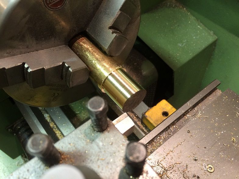

Craig Booth 105/05/2018 12:33:27
84 forum posts
165 photos
got a lovely delivery of stock yesterday, no excuses now

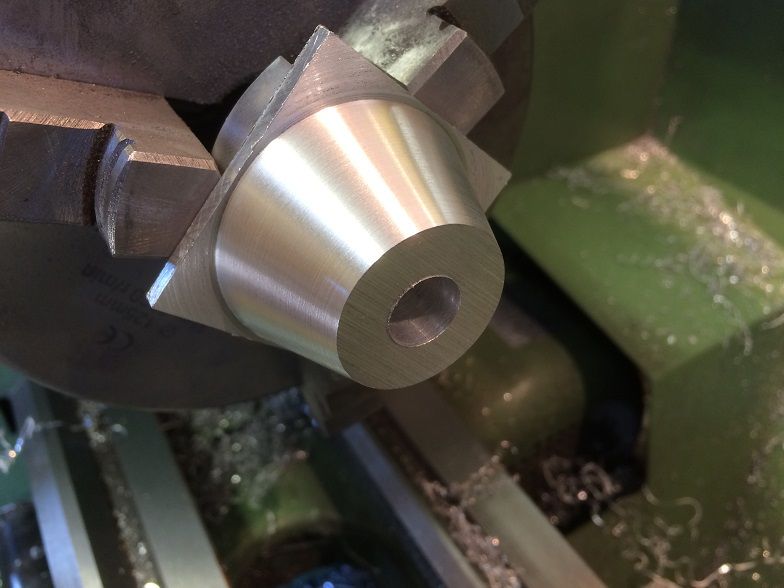

Craig Booth 105/05/2018 12:37:47
84 forum posts
165 photos

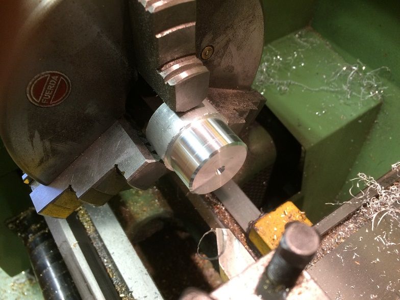

worked on the prop driver. had a bit of a problem trying to get the internal taper on such a small hole. 11.3mm dia at the largest on 6 degrees, but got there in the end.
I will cut the grooves to grip the prop in the front face of the driver once I get a involute cutter, which I will need for the timing gears anyway.

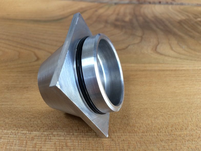

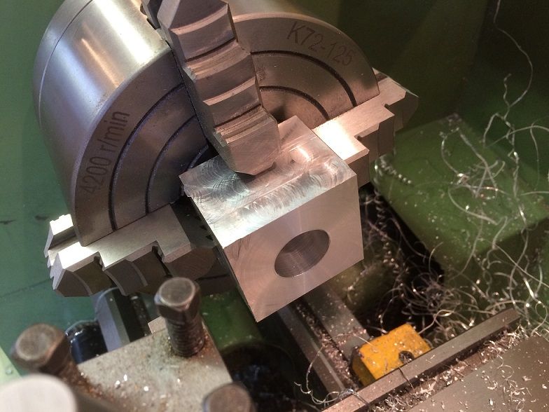

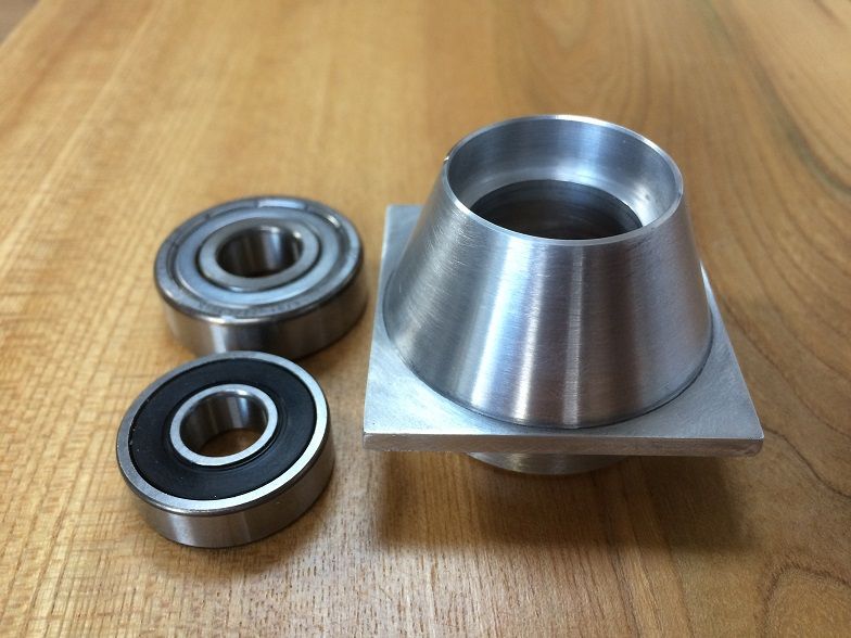

also got around to most of the front crankcase housing. Turned the rear first including seat for rear bearing and groove for O-ring, then flipped in lathe and taper turned inside and out, then front bearing seat.
Remaining square frame is still 0.5mm oversize until I make the main crankcase. Next will drill the mounting holes on the mill.

Craig, my experience with using plastic shielded bearings is that they cause additional friction that leads to overheating the assembly but it may help prevent loss of crankcase pressure.

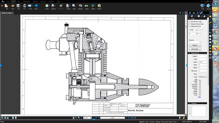

Neil Lickfold05/05/2018 23:22:55
1025 forum posts
204 photos
Is there a sectional view of this engine you are building? Just curious.
Thanks Neil
JasonB06/05/2018 07:11:10
avatar
25215 forum posts
3105 photos
1 articles
Looks like you are making fast progress Nick, when it comes to small holes if you don't have a boring bar small enough then a 2-flute milling cutter held in the toolpost will do the job, may be worth trying when you come to making the carb.

Craig Booth 106/05/2018 11:14:11
84 forum posts
165 photos
Thanks for the warning Emgee, it is a high temp version so I'm hoping will be ok, but will keep an eye on it.
Here's a cross section from the plans.
Neil Lickfold06/05/2018 12:49:15
1025 forum posts
204 photos
Thanks for the cross section. On model engines, instead of using the shielded bearings, they have a shaft seal, which has about 0.03 through to 0.07mm in diameter clearance depending on the seal area length. This is normally just behind the front bearing where it is at it's smallest clearance. The small amount of leakage then lubes the front race. The high reving ones leak quite a bit, but the slower reving ones dont. So on an engine like you are making, shaft seal that is 3mm long and about 0.03 to 0.04mm in diameter will seal the case nicely and you wont have any issues with seal drag either. But is seems you have made the front housing already, so unless you make another it is not going to happen. So in the case above, you would end up making the tapered clearance section about 3mm shorter from the back with a bore concentric to the front and rear bearing diameters, and be 0.03 to 0.04mm bigger than the shaft diameter.
