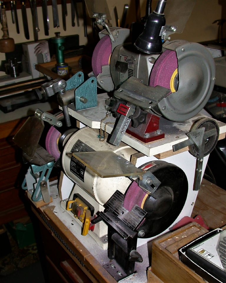

Robbo26/03/2018 22:09:12
1504 forum posts
142 photos
Get another grinder for green grit and mount them like this to save space. (Yes these 2 both have pink wheels, coarse and fine and the lower grinder is a 1400 rpm oldie) These are for woodturning tool sharpening on the front of the wheel.
Martin Dowing26/03/2018 23:23:06
avatar
356 forum posts
8 photos
Thanks for comments.
@Robbo & Baz,
This is perhaps the best idea. Issues related to space were causing most concerns. It is important for stones of top grinder not to allign with your eyes, just in case...
Just try not to buy too many similar machines because even if now space is still there it is not difficult to stuff up workshop to the point that some other machines might no longer be feasible.

John Paton 127/03/2018 09:22:11
avatar
327 forum posts
20 photos
Posted by Robbo on 26/03/2018 22:09:12:
Now that is an arragement I really like - why did I not think of it! With the addition of whetstone wheel for joinery tools and wire brush and mop wheel my grinding alcove is a bit congested and this is an excellent solution. Will make a nice welding project to do a suitable steel frame.

Robbo28/03/2018 11:33:10
1504 forum posts
142 photos
Posted by John Paton 1 on 27/03/2018 09:22:11:
This one made out of 18mm melamine faced chipboard reinforced with oak fillets and left over from a kitchen construction was intended as a prototype to test the feasibility of the idea. So there are some bare edges where it has been adjusted (ie bits sawn off). However it works so well that a "proper" one has never been made.
It has been in use for 15 years + and is plenty rigid enough for the weight of the top grinder and the light loads imposed when sharpening tools.  As it is for sharpening turning chisels very little metal is removed so mess is minimal.
