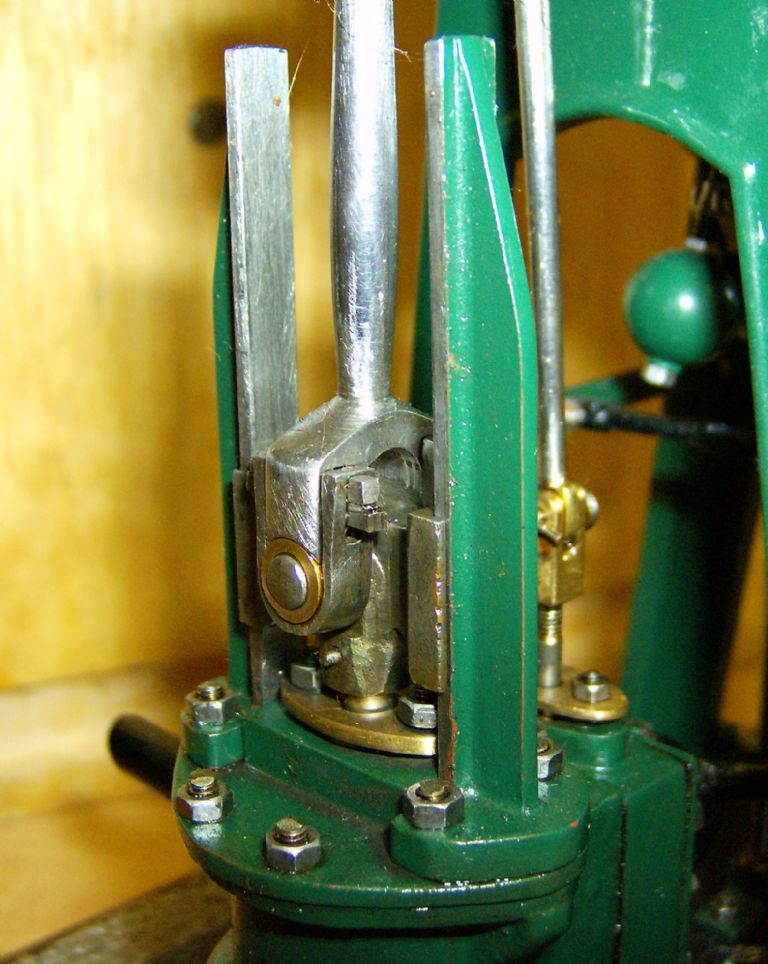

At the beginning of the 2nd WW, my father, a young and newly qualified Toolmaker & Fitter left Archdale's Engineering Works in Worcester to join the Royal Navy. The entrance practical exam at Portsmouth Dockyard for Engine Room Artificers included making a Block, Strap, Gib and Cotter in 42 hrs using only a hammer, chisel and 3 files using no machinery except for drilling holes. I've attached a photo I've found of this type of test piece.
My questions are: what are, or were, Block, Strap, Gib and Cotter and what were they used for. And why were they used to test entrants to the Royal Navy at the start of the 2nd World War?blockstrapgibcotter.jpg

I would guess those would be used for tensioning standing (steel wire) rigging.
Similar arrangements used to be used to adjust bearings.

They're used to connect rods together that are only subject to axial forces. Normally a block is made on the end of one rod and the strap on the other.
The rod and strap are both traversed by a slot. To assemble the fastener, the block and strap are aligned and the 'u' shaped gib inserted so that it's ends lock on the strap. Finally the wedge shaped gib is hammered into the remaining gap to lock the whole together.
The advantage is that the joint can be assembled and dismantled quickly whilst keeping the parts in the same relative position. Once common on locomotives to connect rods to cross-heads and elsewhere to fix rods to stationary parts.
Your picture (which I've decluttered) is the first I've seen with screw-threads. Possibly this is because they are apprentice pieces rather than the real thing.

I've shown this before, similar arrangement of strap, gip and cotter to hold a bearing in place:
