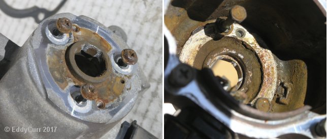

Shall I set to work on machining a split collet adapter to pull a fan hub from an armature shaft, or is an inexpensive & readily available commercial product an option for such work ?
An Armature Bearing Puller has already been applied. The consequent damage to the lip of the hub is visible below and will not surprise anyone here.

I overlooked mentioning the reason for choosing hot air over flame for heating.
The 14mm hub w/ groove highlighted in the inset of the picture above is the only metallic portion of the molded fan/hub assembly. Everything beyond that small grooved hub is black 'engineering plastic' of some sort.
The presence of the groove tempts thoughts that this is a provision for disassembly. Puller damage reveals that the hub is weak - maybe zinc, maybe aluminum.
A split collet design could surround the hub for maximum engagement. On a larger scale, a similar approach is used to remove P/S pulleys with hubs equipped w/ a groove for the purpose. If using a split collet in this manner is a common practice and tools for same are readily obtained, buying would be a faster solution than making at the moment - is anyone familiar with commercial tools like this?

As mentioned above, the fan hub features a groove which is just 8mm in dia, w/ a 1mm shoulder to bear on.
While on the small side as pullers go, the jaws of my armature bearing puller have an inner radius ideally suited for objects of 52mm dia.
The discrepancy results in very little purchase twixt jaw and hub - while the jaw material is up to some frisky behavior, the hub material is less inclined to cooperate. Hence the desire to encircle the hub for maximum advantage and enlarge the circumference available for the puller to engage with.
At the risk of seeming close-minded, split collets of a sort that encircle the hub nearly 360º, are held together/in place with an outer sleeve that can be gripped by puller jaws and allow the push bolt to pass through the center to bear on the armature shaft preoccupy me.

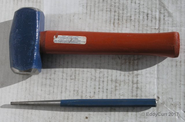

Well, guv - you're third of three who've told me to give the hub a wallop with a BFH. So, I decided to act on your directions, Ian S C.
First, I pulled out my trusty 5 lb sledge, along with a suitable taper punch
Then I anchored the hub/armature, wound that sledge back over my shoulder and let fly, putting everything I had into the swing.
Result !!!
Not only did I drive the hub straight out the back of the molded fan ...
... I propelled the hub, the bearing and the armature smack through the motor housing - extruding the shoulders of the hex on the back side of the hub past the bore for the armature bearing.
I did just what you encouraged me to do, Ian S C.
Is that the outcome you had in mind ?
What do I do NOW, oh sage one ?

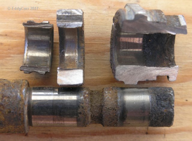

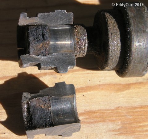

Following your suggestion, I set to work with a few hand tools. I doubt this fettling will earn me an invitation to join the next induction of apprentices at Rolls Royce; but, as the socket illustrates, the end result was a good fit between jaws and hub.
Alas, there was no happy outcome.

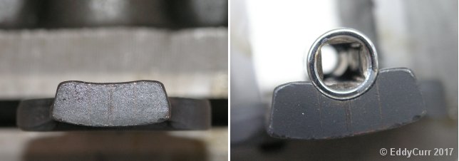

Despite the modified jaws, a good soak w/ penetrating fluid, prewarming to approx 95ºC on a hot plate and tapping once the puller had been wound up tight, the hub did not so much as budge. Additional heat / pull interations with increasing load and more vigorous tapping only led to failure of the shoulder of the hub groove.
With nothing left to lose, THAT's when I pulled out the hammer.
As I think you will agree, the photo below shows that attempting to pull the hub from the armature shaft was likely a doomed venture from the outset.
Again - thanks for your suggestion.  The modified jaws worked as well as the split collet device I had in mind.  Glad I didn't delay and go to the trouble of building something that would not have succeeded against the corrosion.

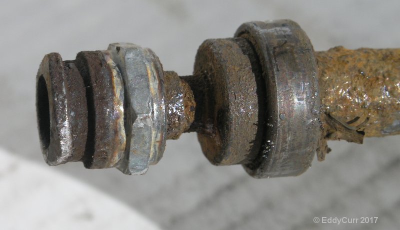

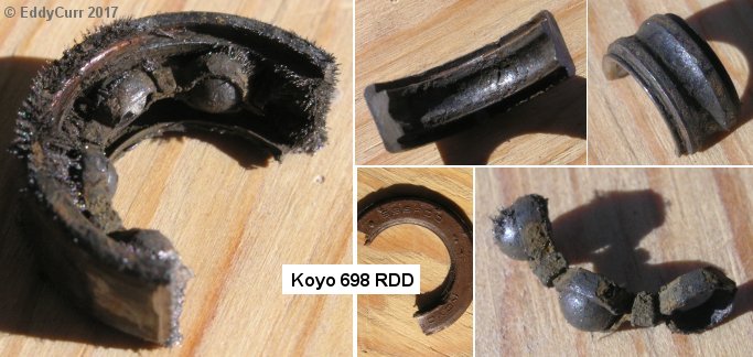

Before laying on the hammer, I briefly considered electrolysis - I had success with this in the past, salvaging a length of shafting found w/ a pillow block seized in place after a lengthy time in the elements.
If applied at the beginning, maybe electrolysis might have made a difference. Turns out that the bore at the outboard end of the hub was oversize, leaving a gap between hub and shaft for some distance.
What I thought was a motor-housing-to-shaft seal (between the hub and bearing race) turned out to be a press-on locking collar - presumably to prevent bearing movement on the shaft. Like the hub, the bore of the collar was relieved, creating another gap for corrosion to grow.
The shaft bearing had seen better days.

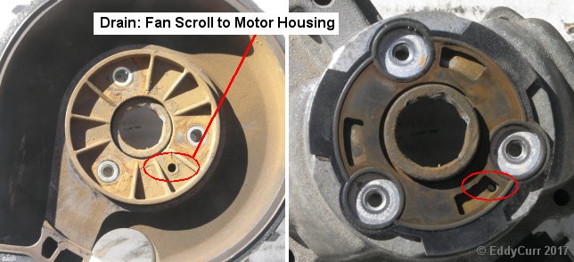

Perhaps a contributing cause to the condition of the bearing was this feature of the fan scroll housing, a drain port leading into the otherwise sealed motor.

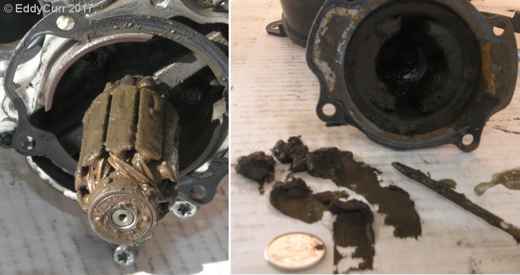

This drain port might also explain why on disassembly, the motor housing was found to be FULL of water and so much silt-like material that the gaps between poles of the armature were packed solid, jamming the armature within the magnets. The photo on the right below shows two trails of silt scraped from between the magnets (with a coin in foreground for perspective.)

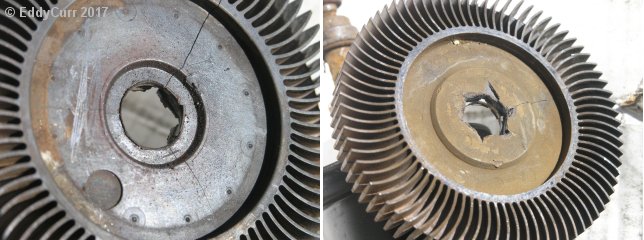

The rest of it looks a little stuffed, but the fan is not beyond redemtion, I had a similar problem with a pulley. I bored the hole out to round, made a new hub, and used half a dozen 1/4" UNF cap screws to fix the two parts together.

Don't suppose the crack from the "bore" to the outer edge will help much. Adaptor would need to be like a chuck backplate.

After initially discovering water/silt filling the motor housing, I imagined the pump was a lost cause. While able to scrape and brush silt from the case and windings, the endbell contents were not accessible with the armature held in place by the fan. Feeling there was nothing to lose, the endbell was simply rinsed out w/ tap water - a lot of debris flushed away. A nod to propriety called for a brief effort to oil the bearings. Then the motor was buttoned back up and powered.
To my surprise the motor ran on a 10A fuse, despite being fitted w/ a 60A in service. Sounded like a blender full of raw carrots, mind you.

Ian S C and Circlip's suggestions regarding fan repair by attaching this to a bespoke hub align with my thinking. As supplied, the fan disk (between hub/blades) has a close fit within the circumference, top & bottom of the scroll housing - some modification will be in order.
If I had whiter teeth, fresher breath and a more engaging personality, perhaps I could persuade a fellow member of a local club who EDM'd compressor blades for his scale turbine to similarly make a replica of my factory part. Alas, I expect to be found wanting on all counts.
