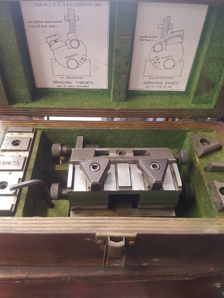

I got my die head and could not believe my luck it was fitted with m8 x 1.25mm chasers the size i need also bought a grinder jig looks like fun to have a go at chaser grinder.jpg

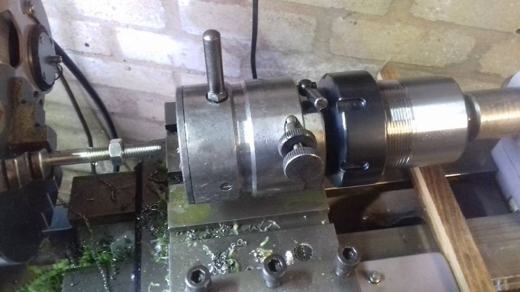

not so sure about thexway its being held

i got it working but the 2mt is not really secure enough it kept turning but managed to cut a good thread on 316 stainless , the chasers i got were slightly rusty and not the correct cutting angles for stainless thik there grade s20 for normal steel so not sure if it would cut much easier with the correct sharp chasers installed but on the plus side its very fast

i have a vertical slide thinking maybe attach to that make something to hild it solid in place might be best option

Ah the posh version! There are at least two variants for different ranges of chasers. Did you also get the tapered 'rules' used to check the height of the newly ground teeth? Old style jigs on the left, then the newer style and on the right the tapered measurement jigs:
Although the chasers came in a variety of throat and rake angles S20 seems to be far and away the most common, especially if buying new. In my experience S20 works fine on steel, stainless steel, brass and bronze. The most important parameter is cutting speed. Too fast and the threads are torn rather than cut.

How many Jigs do I need to sharpen a Coventry Die? Do I need Jig A+B+C? What are these jigs called?
Chas LCov Die Jigs
Andrew Johnston28/09/2018 13:52:14
avatar
7061 forum posts
719 photos
Posted by CHARLES lipscombe on 28/09/2018 12:54:09:
The basic answer is A and C.
Coventry dies need grinding on the taper at the front to provide a clean throat angle. They also need grinding on the flat face to create a new cutting face that is on the centre line of the work.
The fixtures A are grinding fixtures that allow grinding of both faces for a standard throat angle of 20° and a top rake on the cutting face of 12°. All four dies in a set need grinding together. The grinding fixtures come in a variety of options. The smaller ones may only cover one diehead size with two fixtures required for RH and LH. Whereas the larger ones may cover a range of diehead sizes and both LH and RH.
The fixtures B are baseplates that allow the grinding fixtures to be set at different angles for different throat and cutting face angles. It is unlikely you will need these, unless you have dies specifically for brass.
The fixtures C are height gauges and are used to determine the height of the new cutting face so that it is on the centreline of the work. The numbers on these gauges are arbitrary and get larger as the diehead size increases. The exact number is specific to a particular set of dies, and should be marked on each die in a set. If these numbers are different then you don't have a complete set! The height gauges have an overhung rule. All you need to do is grind the cutting face until the die stops at the number engraved on the die when slid along the overhang on the gauge.
If that's not clear i can take some pictures to give a better illustration.
Andrew

Thanks very much for this info, I now have the situation in perspective. Also I know 2 things. Firstly that I have a grinding fixture and a baseplate for 3/8 - 1/2 inch dies but no height gauge( both early pattern). Secondly that I have never missed out on buying a height gauge at autojumbles because I did not recognise what it wassmiley
I don't know what my chances are of buying a height guage on its own but the search is on!
