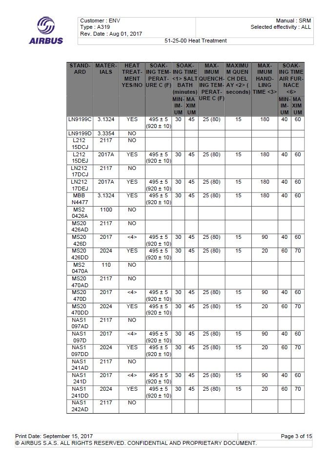

All depends on what type of alloy you're using. If you dont have a part number (which will normally give you the material type) you can check the markings on the rivet head. Colours will not identify a rivet material, the colour is the protective coating, so generally a golden rivet is cadmium plated, silver ones are alclad, blue ones are anodized etc. The head marking denotes type of material, so, an unmarked rivet head is denoted as A, a single dimple on the head is AD, a single raised dot is D, two raised dashes is DD....and so on...
Below is a procedure form the structural repair manual for an A320, with information regarding material and heat treat temp and duration.
If you need further clarification I'm happy to help out wink

If the rivets are unmarked I doubt they will be aluminium alloy rivets, and if they are not an alloy such as 2017, 2024 etc, no heat treatment will be required as they are soft.
Will need to see what rivet we're talking about....
