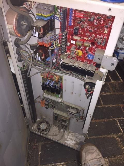

I've been trying on and off between work to get something out and have decided to refit the machine with new hardware. Their is very little information off this machine on the net and so would like help with the process. Both axis move I believe as they should however at the moment my garage is supplied via 2.5mm wire, evertyime the spindle tries to turns it trips the fuse. So I have tried it with a generator and run a pre loaded programme with a degree of success.
My understanding of cnc control systems is basic and so am seeking help in retro fitting this machine. I hope to follow this through on the forum recording how we done this.

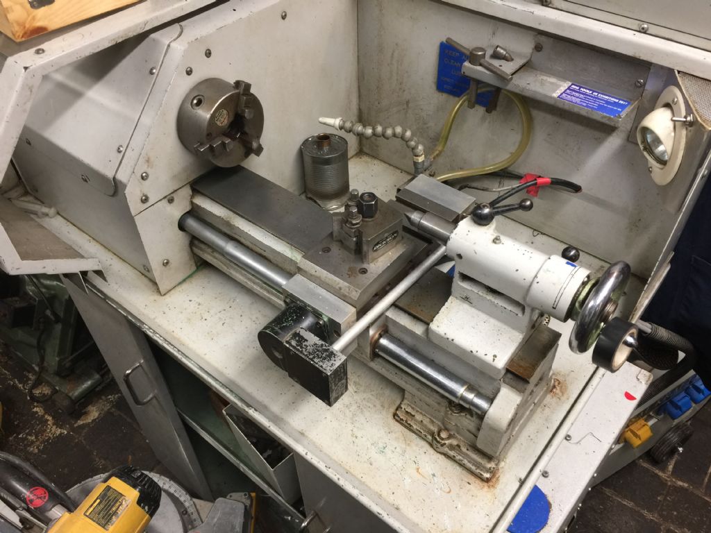

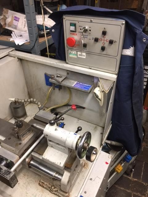

So were do Well finally got them up. This is the lathe in question a connect 121 with the correct spelling. I believe the lathe is in original format however the control panel is mounted in a different position to others I've seen. this may have been modded by the college who previously owned it.
So were Do I start or even how. Do I need to change the motors for the axis feeds or even the spindle motor? As mentioned earlier I have had the spindle up and running via a generator albeit a little inconsistently. Do these lathes actually require so much electricity to run or is their a problem with the circuits on this lathe?

There's an interesting thread on these machines. John Stevenson obviously knew a fair bit about them and there are links to interesting stuff on his website like the PC software manual.
There's no sign of the control computer in the photo. Sounds as they started out with a BBC Micro and then moved to IBM PC. Do you have anything like that?
To be honest it doesn't really sound as if you know what you are looking at here. Not meaning to be disrespectful when I say that but this machine will be pretty much unusable in its current state, even if the original system is functional. If you succeed in making a working CNC lathe out of it, it will be by completely replacing almost all of the electronics you can see in that cabinet and fitting a PC running either Mach 3 or LinuxCNC - or possibly one of the recent CNC controllers like this that John S was discussing recently. There will be a lot of learning and elbow grease (and expense) to get from here to there...
Seems these machines were based on the Myford ML10 but I doubt there would be much point trying to revert it to a manual machine as they are actually quite different in the end.

Seriously though, you should be OK with generic motor controllers and it may be cheaper and/or easier to swap out all the electronics and use a modern CNC driver.

Frankly I agree with Murray and Neil, it would probably be better to dump the electronics and replace with modern stuff, though the PSU transformer is probably reusable. The electronics for my Super 7 conversion probably cost not much more than £120 - a pair of stepper drivers & stepper from Arc, a BoB from cnc4you and sundry transformer etc from RS. You could do significantly cheaper on eBay from China. A new spindle controller probably also needed - KB electronics do good ones but there are also cheaper available on eBay.
I found it pretty straightforward to do. The lathe should not use much power - the spindle motor is 0.5 hp so ~500 watts, the electronics should be about 200 watts max. Either a surplus PC or as suggested above a dedicated CNC controller. I have also converted a Novamill which is probably a similar vintage to your Conect - I didn't fit new stepper motors and the originals seem to work fine, but new motors are quite cheap if needed. I use Mach 3 and have found it pretty easy.

If you download the Conect lathe pdf manual from Muzzer's JS link you will find all you need to know about manual testing and cnc operation of the lathe, a very comprehensive well written manual.
You may find all is working as designed and there are many canned cycles programmable that will produce parts needed, you will just have to write a few lines of G code, all codes usable are included in the manual.
You say the fuse is tripping, fuses either blow or remain intact, circuit breakers trip so there may be an earth fault on the lathe which trips the RCCB on the socket supply, try disconnecting the spindle motor from the motor controller before trying again.
If you want to go the CAD/CAM route then it will need a complete refit as stated by others, this may not give any better accuracy than the standard setup because of wear/play in the screws but it would allow you to work from dxf files.

If your RCB is tripping on this but not the Harrison then probably it has an earth fault in the motor controller - that needs fixing anyway for safety reasons.
