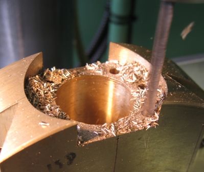

Most of the mechanical work, wiring and software for the Shaper, now reborn as an NC shaper, is done. Z axis stepper wiring still to complete, and then software tests start. All the software functions have been tested 'on the bench' and the next step is to get the actual axes moving ( auto-feed) so that stepper accelerations with the associated inertial mass of the axis table and slide can be calibrated.

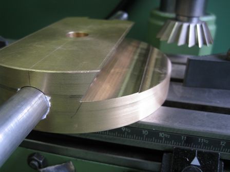

The broken vertical axis dovetail has been replaced, new dovetails cut, and thank goodness that worked out very well indeed. The vertical slide itself was undamaged, but I opened up the dovetail from 55deg to 60deg, as that was the cutter I could obtain..The mating dovetail was then made from a disc of PhBronze and a 16mm ballscrew fitted in place of the old, very damaged and worn acme leadscrew..
Hope to make chips in a week or so!
Most of the work leading to this stage has been covered in a number of my posts, so here goes maybe one last one..

Machining the Male Dovetails in the bronze add-on. The cutter is 65mm OD..
test fit of the two halves
Drilling and tapping the fixings for the ball nut

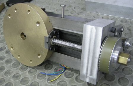

Ball nut and screww fitted
Holes to bolt two parts together all drilled - counterboring for Capscrew heads next:

Thrust Bearing block for Leadscrew Bearings and Drive pulleys.
Start of assembly of complete vertical slide:

If the entire dovetail is a bronze does it or the gib wear first? :v

Rainbows..?? - Well, I suppose it would, rather than the Gib, but then PhBronze has been used in many a bearing surface, and these seem to last many years - The slide does not move that much - its not as active as a lathe top-slide for example. And if the bronze does wear a little, just screw the Gib screws in..
