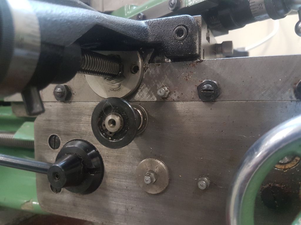

Aaron Frederick24/08/2017 15:26:42
3 forum posts
1 photos
I recently purchased just a standard issue Myford taper turning attachment for my Super 7 lathe and I have a general question that probably doesn't warrant its own thread. It is a power cross-feed model, and I am wondering what would be the best way to disengage the cross-slide to allow me to use the attachment?
Would removing the cross-slide front bracket disengage it completely and free the cross-slide completely? Or do I need to also unscrew the feed-nut partially? I don't have the attachment yet, probably will work it out when I've got it but some advice would be appreciated if anyone could help.
Myford Cross-slide
Edited By Aaron Frederick on 24/08/2017 15:27:01
Tony Pratt 124/08/2017 15:31:51
2319 forum posts
13 photos
I just remove the 2 cap head screws holding the bracket onto the cross slide & wind the screw outwards if necessary to clear any movement of the cross slide when being driven by the attachment.
