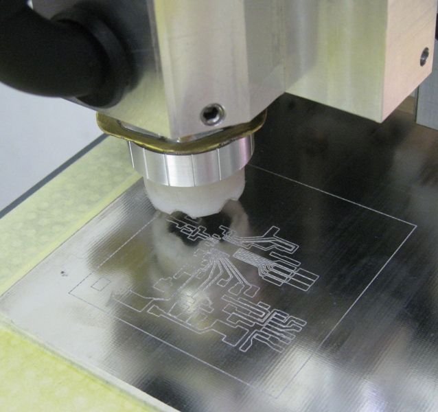

Hi Colin,
I built my own 'mini-router' specifically for isolation engraving of PCB's. The kind of PCB's you want to do will determine the characteristics of the machine.
For very fine tracks ( I do down to 0.4mm tracks with 0.4mm spacing between tracks..):
The machine should be as rigid as possible with 'no' backlash in the leadscrews.
The spindle should be as high speed as possible ( 20000RPM is good, 30000RPM is great), The cuuter tip is very fine - maybe around 0.15 to 0.2mm at the cutting edge, and speed is needed.
The cutter geometry is critical - D-type engraving tips made from fine-grain carbide are needed, esp if working with FR4 - a fiber-glass PCB substrate. Cutter penetration is a scant 20um to 35um, so only the very tips does the work, and if that tip grind , relief, etc, is incorrect, all you get are ragged burrs and poor engraving!
And last, but very necessary, a floating spindle makes for a good engraving! Since the engraving tip is conical, the deeper you go, the wider the groove, and the more you cut away of the copper track sides. So maintaining depth is critical. Trying to get the router table perfectly flat is not easy - the frame of the router is flexible enough that if the machine is on a table top, just the flex in the table top makes for many 10's of um twist in the router table, which mucks with your depth. And then the PCB material is not perfectly uniform in thickness either, and it is almost impossible to keep the PCB flat on the router table either - some folk superglue it down, etc, but flat is never is. So, use a floating spindle , running on a teflon foot on the pcb, and depth is fully controlled.
If you get a handle on these elements, then the process works, is totally repeatable, and makes great PCB's - I have made hundreds this way!
Here are some pics of my engraver and an example PCB for a very fine pitch surface mount IC..
The machine table is about 400mm long by 300mm wide - small but very rigid.
Mini-Router/Engraver
CNC Engraver Floating Head
PCB Being Engraved

Joseph Noci 109/12/2017 20:13:16
1323 forum posts
1431 photos
Hi Brian,
The floating spindle is fairly simple - the spindle ( itself just an RC brushless motor the main shaft of which removed and fitted with an 8mm long body ER8 collet chuck) - sits on the horizontal cross member in the photo below. That member has two 10mm vertical shafts that slide in the two aluminium blocks ( left and right) which are fixed to the Z axis. The nose of the spindle has a fine thread screw-in cone, fitted with a PTFE 'shoe' that rides on the PCB, with the engraving tool set to protrude below the shoe by the depth of the copper on the PCB - about 40um or so.
Some pics that may assist:
Spindle bussines end-
The floating 'foot'
The 'grooves' in the PTFE foot are so air can be sucked in via the vacuum attachment - see later pic down the line.
Floating Head in down position
And here in 'raised, position - as it would be when the foot touches the pcb and lifts the head.
The black elbow pipe in the pic above is a Vacuum attachment point - sucks up the debris through the nose cone and foot, keeping the PCB clean and clear of shavings - else the foot rides high and the engraving tip does not penetrate properly.
These tracks have a 0.12mm isolation cut ( the light shining through the groove) and the pads in the center for the IC are 0.5mm wide.
Hope that helps - ask if your want more detail. Important that the slide that the spindle rides up and down on on the Z axis ( not the z Driven axis..) is a close fit - no slop, since this will translate to poor track definition and resolution.

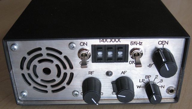

Joseph Noci 110/12/2017 06:21:53
1323 forum posts
1431 photos
Pete, I used to think like that as well..It does take a little longer for me to get boards made your way - Shipping from UK/China/wherever to Namibia takes long and costs a LOT more than $36..
But that is not the point. The router, if built decently and sturdily, is not just a PCB engraver. It does a sterling job of front panels for projects - easily do the lettering and control definition, route out the holes to fit controls, etc. And then route the enclosure panels out - I use single sided FR4, 1.6mm PCB, and then simply solder up the enclosure by solder tacking all inner corners lightly.
Colin mentioned the intent being as a tool to supplement his Radio Ham hobby - As a fellow Ham, I use this tool almost daily. I do a circuit design and PCB layout after Dinner, Engrave the PCB the next morning in a half hour - assembled by lunch, discover the major snafu before dinner, and do a new layout after dinner. By the next afternoon the board is assembled and tested and I start the enclosure and front panel layout. The next day the enclosure is together and the project done and dusted...and it cost maybe $2 in PCB material...While you are still waiting for your boards to arrive, and to discover your Snafu...
Here is a Wildlife Collar Tracking Receiver I made - enclosure all PCB, front Panel routed and engraved likewise.
And here are the 'modular' PCB's for the various electronic gubbins that make the receiver.
Try making commercial boards for that, and carrying the cost of repeats while you experiment..

So, Don't knock it till you have tried it - I would not trade it for ANY PCB service!
Regards
Joe

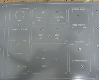

Joseph Noci 110/12/2017 06:44:09
1323 forum posts
1431 photos
Another 1 or 2 front panels made in the same way -
This the control panel for my NC Shaper:
And the completed panel:
The Control panel for my Maximat V10P ELS system - all in FR4 PCB.
.......Joe
