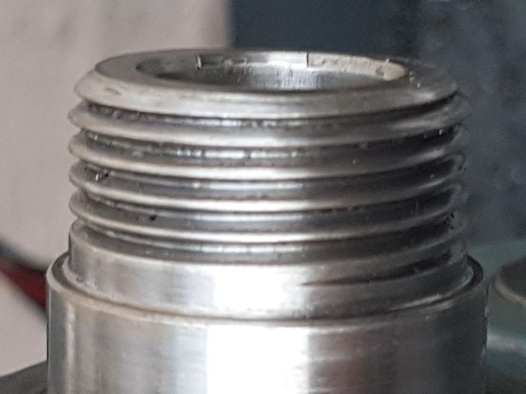

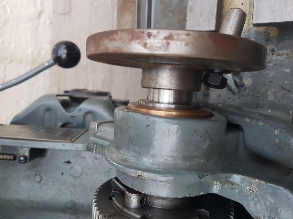

Nicholas Hill03/07/2017 20:56:00
33 forum posts
32 photos
Hello again, and thanks for the replies. Bearing in mind the information about where the chuck should sit, and the force required, I have come to the conclusion the spindle is the problem.
I tried today with two different chucks and two different face-plates, and got the same results. After about half a turn, it sezies up completely, still a good 1/4" away from the collar.
The threads look ok, on both the spindle and the chuck / plate threads, so I am at a loss...I want to get the chuck / plate on first, before I think about the bearings, I am still hoping I am doing something stupid, but screwing something on seems so straight forward I don't quite know what.
To my eyes the threads look ok, but here is a picture of them:
This is as far as I can get anything on:
Nick...

Posted by Nicholas Hill on 03/07/2017 20:56:00:
Look at that thread with a magnifying glass, I can see bits of swarf in the photo.

speelwerk03/07/2017 21:11:27
464 forum posts
2 photos
You will have to check the spindle thread very thoroughly, small chips can embed themself in the thread and swiping it with a cloth or brush will not remove them. You will have to remove them with a small tool. The same is true for the thread of the chuck you try to fit. Niko.
Clive Brown 103/07/2017 21:14:31
1050 forum posts
56 photos
I use an old toothbrush to clean swarf out of my Boxford spindle -nose and the chuck backplate threads.
Dont really know the Myford, but I certainly wouldn't put a UNF die on the spindle theads. I'd expect it to be Whitworth form.
Harry Wilkes03/07/2017 21:26:47
avatar
1613 forum posts
72 photos
The thread on my S7 is 1.25 whit x 12 TPI Chronos do a die link

Mike Poole03/07/2017 21:51:25
avatar
3676 forum posts
82 photos
The Myford spindle nose is 12tpi 55deg Whitworth, I doubt you will find a die as it is non standard. Taps are available. the nose is hardened and would not be kind to to a die. The nose thread should be perfectly clean before fitting a chuck and also the thread in the chuck backplate. As you have tried a couple of things on the nose it may well have a piece of swarf pressed into the thread. A brass wire brush is useful to clean the thread and a pick or scriber to remove anything that will not brush clear. The chuck thread is a little more difficult to clean but people often bend a piece of thick wire so it has two points to engage in the thread and screw it down the thread to clean it. The chuck thread will need to cleaned every time before mounting it. I would strongly resist the temptation to do anything drastic to the nose as it is a precision piece of machining. Get it spotless and inspect very closely for any damage and do no more than is absolutely necessary to correct the damage. The register which is the diameter and face beyond the thread is made to a very tight tolerance and unless it has sustained any identifiable damage should not be touched. Any polishing will affect its dimensions even with very fine abrasive.
Mike
Well while I was typing Harry has found a die but I would seriously resist the temptation to use one on the nose.

Nicholas Hill03/07/2017 21:52:13
33 forum posts
32 photos
Yes...I did consider the link belts, but read a review that they were much noisier than the normal ones....I think I will suffer with the noise in future!
I shall try the suggestions regarding cleaning the thread, I didn't realise how sensitive things were.
Thanks for the recommendation on the Chronos Die. If I can't sort things by cleaning, I shall be getting one.
On the good side, no one has spotted any obvious damage to the spindle, so hopefully a good clean may sort things out.
My slight worry is that it was such an effort to remove the chuck, that it may have been forced on by the previous owner, who didn't have access to this very informative forum. Any swarf may be firmly embedded.
