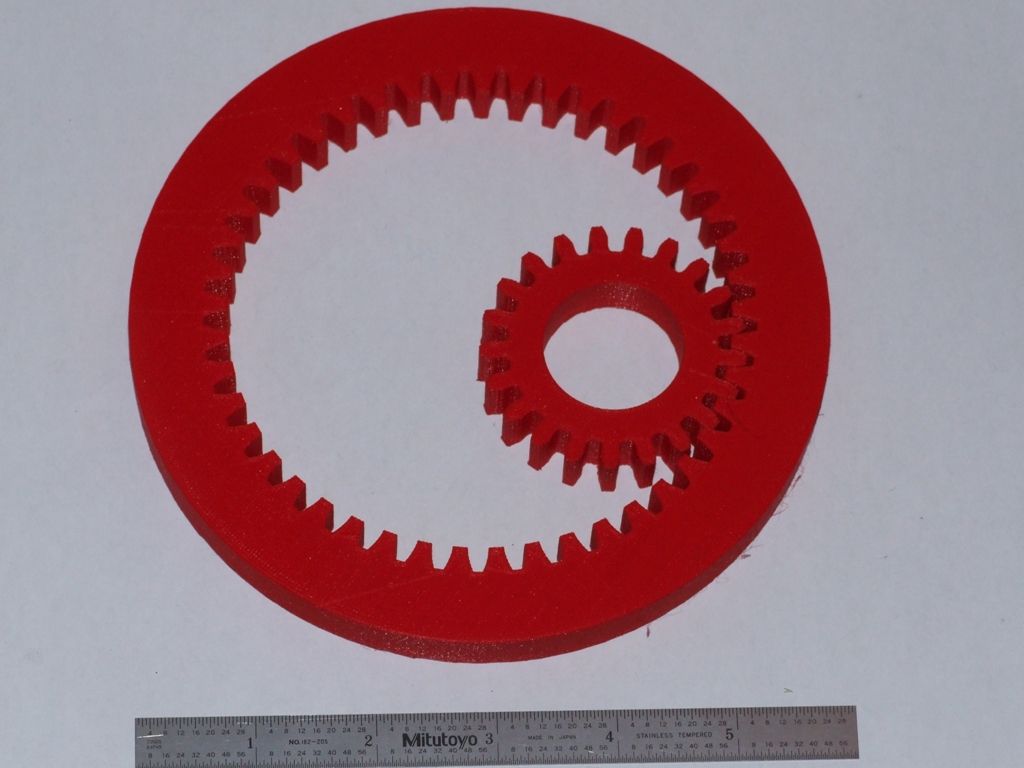

@Neil - having seen your posts on 3D printing thread - is there any reason for making brass gears as opposed to 3D printing the same? If it's aesthetics, I "get it" as I'm sure brass looks much better than plastic
Just curious...
Andrew Johnston10/07/2017 15:00:55
avatar
7061 forum posts
719 photos
Posted by Andy Carruthers on 10/07/2017 13:51:13:
......... is there any reason for making brass gears as opposed to 3D printing the same?
Probably a question of accuracy versus resolution, plus it's a right royal PITA "deburring" the flash. Although of course it is perfectly possible to 3D print gears:
These are 10DP if I recall correctly.
Andrew
