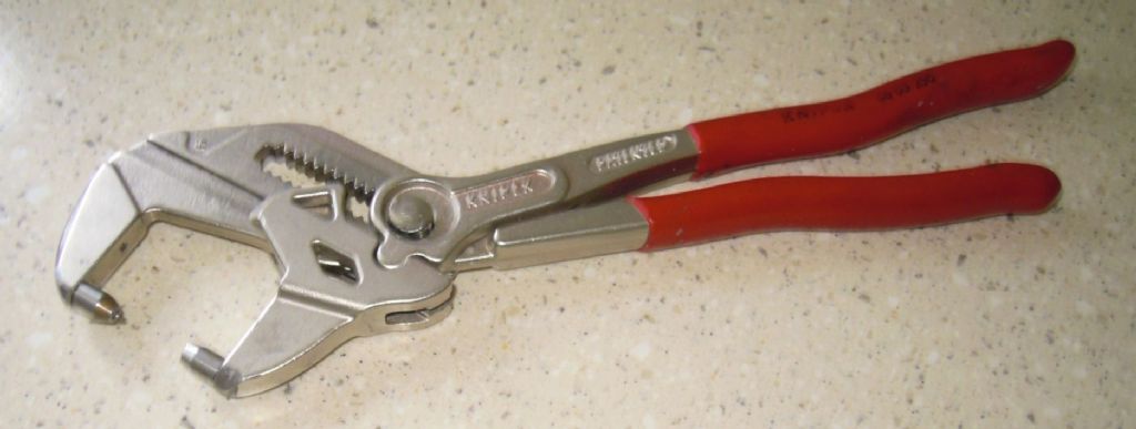

Johannes Grabsch10/04/2017 17:18:33
avatar
22 forum posts
2 photos
Modify a Knipex plier...
Works fine...
You need to drill the jaws, the formers are simple turning jobs. Some common sizes I did harden.
Johannes
