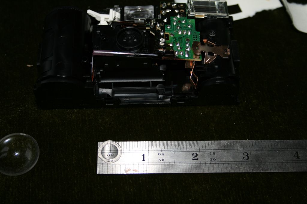

Hacksaw20/11/2016 10:11:06
474 forum posts
202 photos
Bad news RRMBK sad
Only one camera left...but lets dissect it anyway..laugh
Reaps a free AA battery !
Oh dear ,the lens is not from a camera !!
Cripes , that capacitor gives you belt ....surprise
Sorry i don't know ,and nor does the family, where the bigger lens came from...maybe an LED torch that broke.
