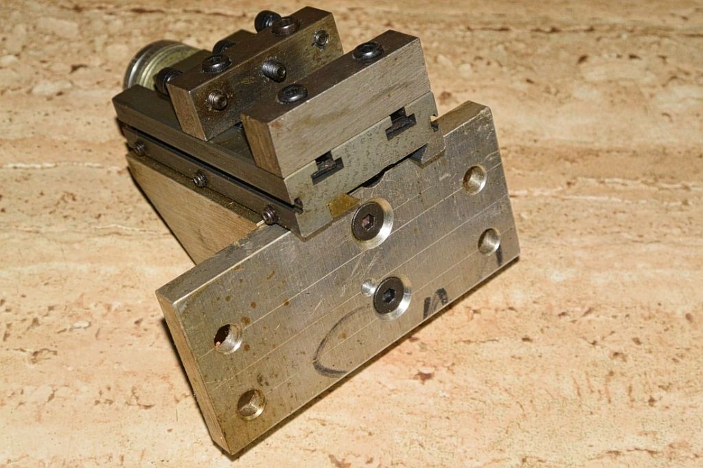

The table on the Taig vertical slide is 3 3/4" x 2" and the mounting base 2 1/4" wide by 2", The vertical travel is 1.4" when the feed thread is at the end of the nut so 1.5" is probably ok. With say a 1/2 dia cutter that means that a 1.9" vertical surface can be milled. Probably 2" in practice. I think they could have fitted a longer feed thread but it's a conservative design so leaves plenty of the dovetail guide engaged, About right actually twice it's width. The width that can be milled depends more on the cross slide travel on the lathe. If parts are reasonably rigid it doesn't matter if they are wider than the table.
The only other dimension you may need is that the table projects 3/4" below it's base in the lower position and the lower "jaw" is 1/2" thick. If you or anyone needs others just ask.
This is mine - didn't sell it with the lathe as they can be useful.
and this is how I mounted the plate on the bottom
I just tapped it's fixing holes but it would be easier to simply fix from the top as it's usually mounted. For a Taig there is a slide down brass plate at the rear so that engages with the slide to make it square to the axis of the lathe.
You have a T Slot that attaches the compound slide so could mount it on a plate and hold it in place with that - 2 T nuts. I've taken the shot with the table right down so that it projects past the base - it's important to allow that to happen otherwise height is lost.
If you do it there will be a need to do some sums to get the max possible travel and that may set how thick the mounting plate needs to be. You may find that it needs to be offset from the T slot to the centre of the lathe so the fixings into it are always in sight or they might turn out to have to be under it. No problem just means fitting 2 parts when needed. I don't think it would take long at all to make the parts needed. I don't think that adaptation actually took me an hour to do
The vice on them looks crap but actually works rather well. It holds things tight and it's easy to make custom jaws in it.
Pass on using these on a mini lathe which might be your next step but I think Neil may have given one of these some serious abuse on one without problem. Some one or the other has anyway.

First thing is to either buy the Taig vertical slide or make some sort of clamp to fit to my lathe. Nothing can be done until then. I think it might be easier to stick with the instructions and machine a flat surface on the cylinder. Cutting a curve on the steam chest is all very well in theory but it might raise some unexpected problems with respect to the ports and threaded holes.

If you do buy the Taig slide Brian at some point you could increase the vertical movement by a fair amount by making an extension for the feed wheel and a longer lead screw. They don't do this because it would hit the bed of the lathe. Packed up to suite the centre height of your current lathe I don't think you would have that problem but you would need to check against the sizes I quoted. They have imperial graduations by the way. Not sure if metric is available. They use 0.050 per turn with 0.001 " graduations. I guess they could be fitted with M6 all thread and then 1/2 division would be 0.1mm
There is another option as well. Something it seems all Rolls Royce apprentices used to have to do. Make an "angle plate" to attach the compound slide to and fix to the cross slide and use that instead. The angle plate could be all sorts of things including maybe a length of largish sized aluminium square section or what ever that can be found that looks to be suitable. The usual problem with this sort of thing is similar to mounting a Taig slide on the cross slide where the toolpost usually goes - it's likely to be much better offset towards the centre of the lathe to make full use of the travel. That can be done in the same way as I suggested for the Taig slide or maybe the part used may be big enough to do that.
I'd guess that the Rolls Royce lot did it all on a lathe and maybe a drilling machine but they would have a face plate and 4 jaw available however Jason has shown how a flat face could be fly cut onto some bar standing on end and lathes can drill with the drill in the chuck and work on the cross slide. There are probably all sorts of options.

I remember months ago somebody warned me about fitting a vertical slide to my lathe. They said the lathe would be too small to give good results. However, the parts need to be made and if the slide does not work out then it will be used on my next lathe when I buy it. At this point, I am not quite sure how it will fit on my cross slide but I hope things will become clearer when I have it in my hands and I can see the fittings, slots and holes.
Edited By Brian John on 04/09/2016 01:58:49
Ajohnw04/09/2016 10:56:37
3631 forum posts
160 photos
You may need to take it easy with cuts Brian but it wouldn't surprise me if you didn't even need to do that. I most certainly didn't need to on the Taig. It would easily cut a slot in from the edge of a piece of 3/8 m/s with a 1/2" end mill and then add a recess in that with a 1" dia woodfuff key cutter. That was cutting at it's full diameter at the end of the slot. Feed rate may have been a little slow compared with a miller but in real terms as fast as I would have done it on a real miller anyway. Only problem really on the Taig is that this probably isn't good for the headstock as it's in 2 parts that can move under load. No signs of that though but some later rather heavy turning did distort the head.
You may need a DTI and small stand to square the vertical slide up to the lathe's cross slide at some point. The brass plate on the back of them does this on a Taig. There will be some way of achieving something similar on your lathe but it will still need setting up. Maybe a similar brass plate that rests against the front side of the cross slide if you mount it on a piece of plate.
