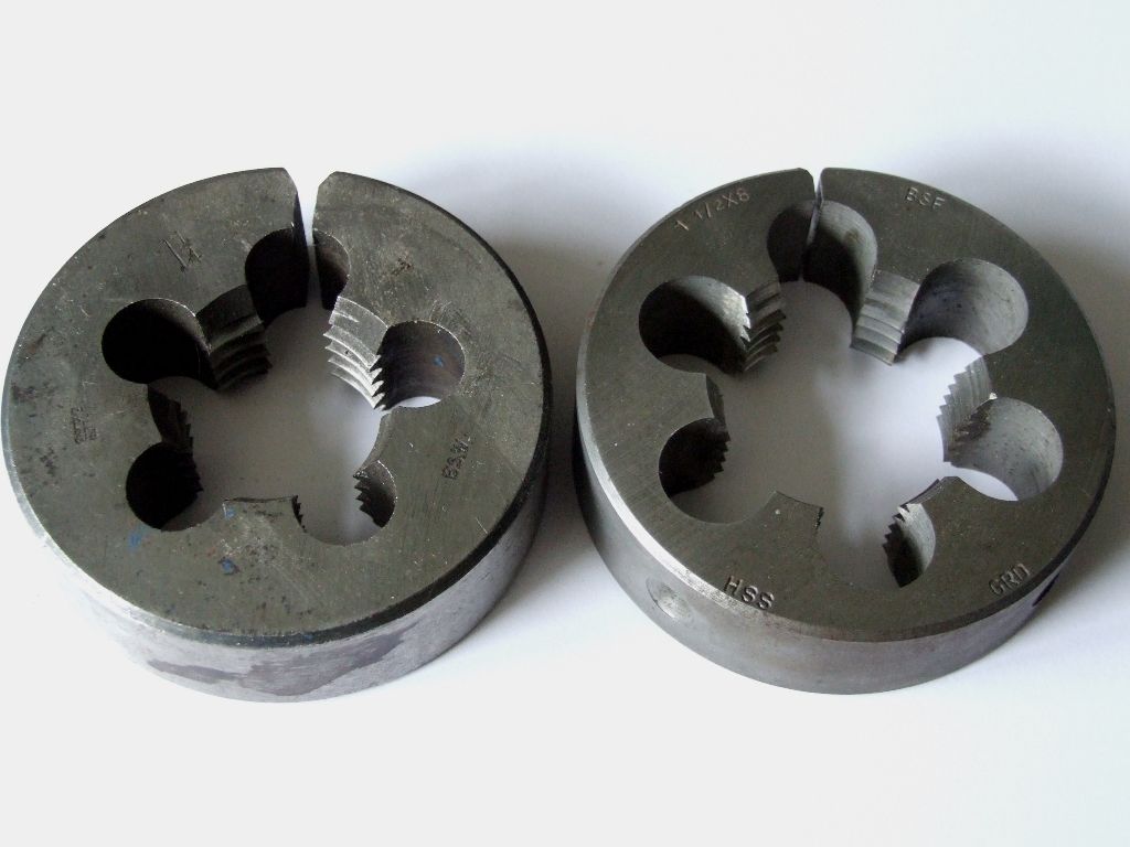

Can die nuts be used to form a thread on steel bar? I remember reading somewhere that they are designed to touch up existing threads. Nut in question would be 1 1/4" BSW.

In a word ... No

As Michael says, even if it were a split die you would probably rip your vice off the bench trying to turn it round with a 4ft scaffold pole on the end of the diestock. Really only for cleaning up existing or final chasing of a partly screwcut thread.

Here yer go; die on the left is 1-1/4" BSW, the other is 1-1/2" BSF, both 3" diameter:

Pipe threads of a similar diameter are a much finer tpi so you are removing about 26% the metal you would with a 1.25 x 7tpi whit dienut.
The other advantage when using pipe cutting dies is that they have a lead in guide as part of the die. They are made to cut threads not clean & repair. I use this one quite often but even with something fairly small like 3/4 " BSP (just over 1" OD) it takes a lot of effort. This one is being used for 3/8" BSP on a model.
Also worth remembering that Rainbows wants to use this as a lathe spindle so got to be nice and true. It was the practicalitioes of using a big die that I was pointing out not querying their existance. Michael W just becasues split dies exist doies not mean they will easily cut from scratch, they can be used to chase as screwcut thread and fine tue the fit whereas a diesnut can't be fine tuned.
The other proplem with cutting big coarse threads is physically holding the part, you really need a pipe vice with its serated V jaws as a chuck or bench vice will be hard to do up tight enough.

I tried a 1" die when making some keel bolts, no luck at all! I screwcut the threads and finished them with the die. I suppose a guided die may work if you have to do it this way. I've cut hundreds of 25mm conduit threads by hand, it's a bit tiring if you spend a day doing this. The spec of the steel may be the decider.

This for your mandrel nose, I guess?
I would screwcut it, there's no way a die that size will cut a spot on thread straight off. You CAN use a die nut to finish the screwcut thread.
