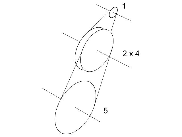

Oh dear this is getting confusing . I have 3 pulleys on my Drummond 3b not a round bed am using the top one which i thought to be a 4" inside and 4.5" outside. The belt runs on the brim of this as its a round profile.
The motor has also there pulleys I am in smallest with 1" inside and 2" outside this runs well in the v shape
I have a 3000rpm motor and used which is a really good site .
rpm for lathe
This said it should be running 750 . So if i use two indermediate gears with 5" as drive to 4" on lathe and 4" to my motor will this not give me 600? I understand this is the correct rpm

SillyOldDuffer02/07/2016 20:43:26
10668 forum posts
2415 photos
Hi Martin,
Yes if you mean this way
Edit
Whoops I got the diagram wrong.  Will try again in a minute!
Edited By SillyOldDuffer on 02/07/2016 20:46:17
SillyOldDuffer02/07/2016 21:15:02
10668 forum posts
2415 photos
Hi Martin,
Second attempt to get the diagram right!
Cheers,
Martin Newbold02/07/2016 21:46:12
415 forum posts
240 photos
No Dave , your diagrams not right middle should be 4 and 5 and bottom 4. is what i thought from my pages and post above.
So 1 to 4 sharing spindle  5 to 5
Cheers
Martin
Edited By Martin Newbold on 02/07/2016 21:48:05
Martin Newbold02/07/2016 22:29:21
415 forum posts
240 photos
Actually i think you are right Dave but this is not going to work for me as have 4 on lathe and 1 on motor
