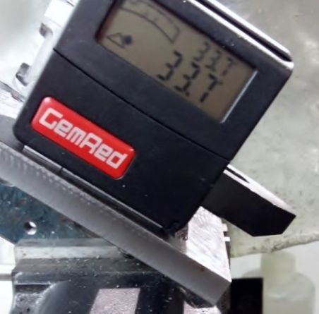

mechman4811/07/2016 11:34:59
avatar
2947 forum posts
468 photos
I set up the cylinder as per the book in the 4 jaw chuck with equal thickness packing which helps to align the port face up for machining, to ensure squareness I ran a dti across the face & with some judicious nudging got an equal reading across the face.
When it comes to machining the steam passages I set up the cylinder on an angle plate set in the vice & squared up the steam passage calculated centre line with a square then drilled both steam passages. The book says the angle should be between 25* - 30*, my angle gauge shows 33* but given the casting discrepancies a degree or two either way shouldn't raise any concern.
Passages drilled...have come out nicely in the port centres.
