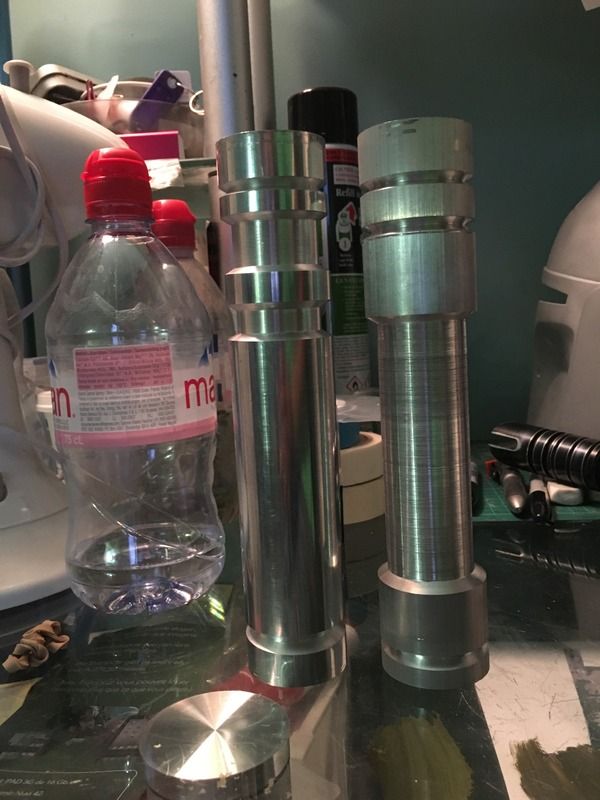

I fixed the photo although I'm a bit confused what it is meant to show...
See here for info on posting from Photobucket.
zak moussa25/06/2016 02:52:42
17 forum posts
Posted by Neil Wyatt on 24/06/2016 21:29:38:
its the work I did experimenting with the Lathe which broke the lathe (maybe indicating stress etc which could have broken the lathe)

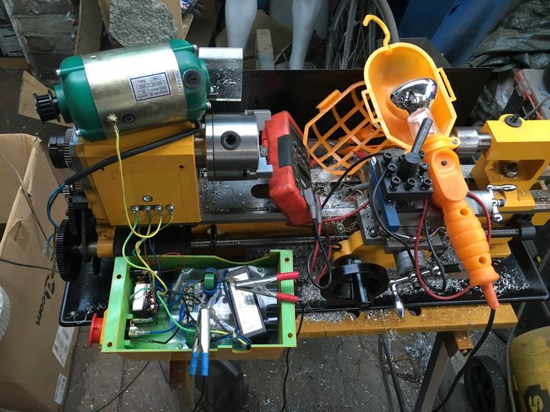

Thanks for replying:
Ok purchased a car battery (cant be bothered using mine from my car was only £20 anyway )

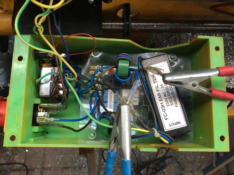

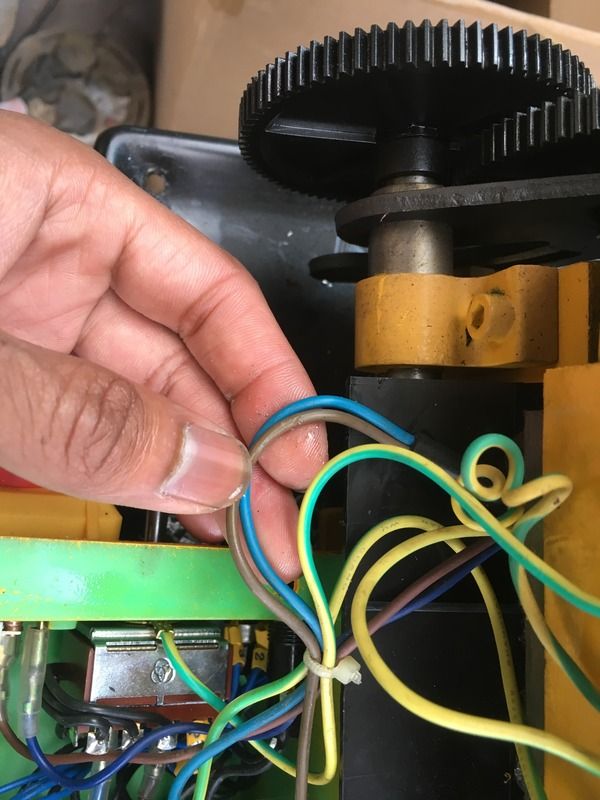

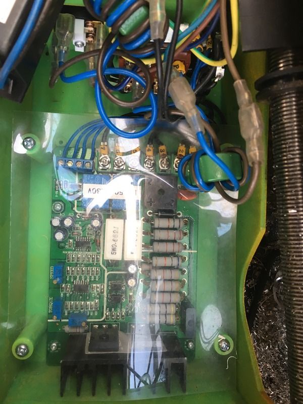

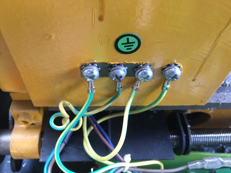

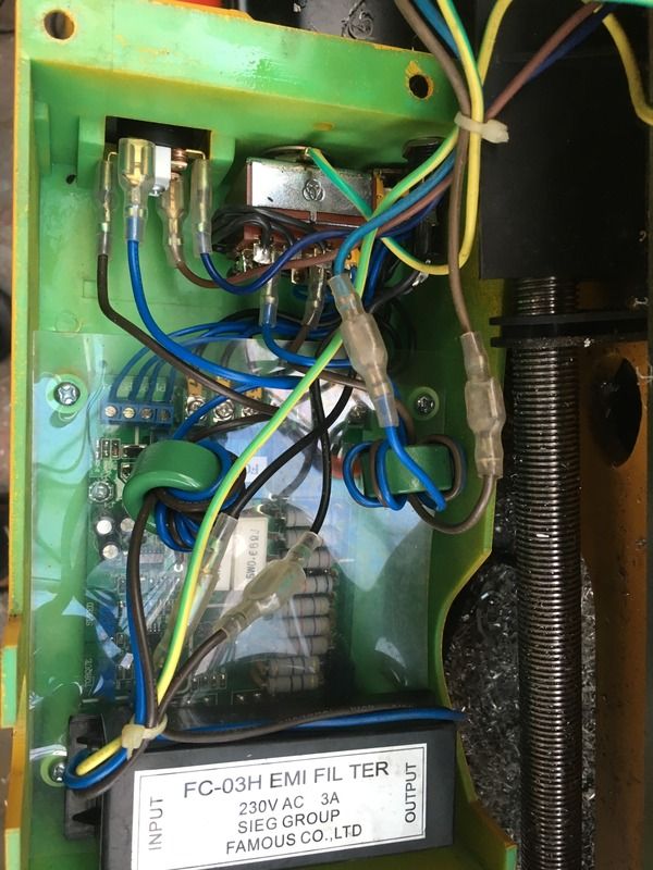

Here is my current set up,
There are multiple wires so just trying to figure out whats what,
My guess for the motor is :
Brown and blue is +
Yellow is -
i have no idea how to test the controller
 photo 08935445-8A0C-4ED0-A1FC-A556BE4F153D_zpstrvh2qag.jpg photo 0DAF3A1F-8BA6-4D91-A4D4-C13BF4DBD6CF_zpszrnro7jm.jpg photo 7E1135DD-4833-4A37-BF56-EDC5ED1FE5A4_zpseuwzq6vo.jpg photo A61FCD7F-98EB-419B-863E-C6C621190EFA_zpsyfiytq4o.jpg photo A61FCD7F-98EB-419B-863E-C6C621190EFA_zpsyfiytq4o.jpg
Edited By zak moussa on 25/06/2016 14:01:00

These mini lathes are prone to destroying themselves.....just be careful in what you replace....there's always a possibility that although you are replacing say a blown pcb, the underlying cause may not have been found.
So, on to testing .....
Follow the wires from the motor back to where they connect to the control box.
Disconnect it, remove from the lathe, check the brushes first and the condition of the commutator.......before doing anything else.If all is well, connect to your battery, doesn't matter way round the wires are connected.....the motor needs to turn freely and smoothly with little or no sparking from the brushes.
Next, connect a mains domestic light bulb to the wires where the motor was connected. Does the bulb light up full when power is applied or can you vary the brightness with the speed pot?
Conduct these two tests and feedback your results.....please.

john swift 125/06/2016 14:36:47
avatar
318 forum posts
183 photos
Hi Zak
I see from the photos your lathe has the FC250J speed control board
they have two FET's on the heat sink that have a habit of going short circuit
if you over load the motor

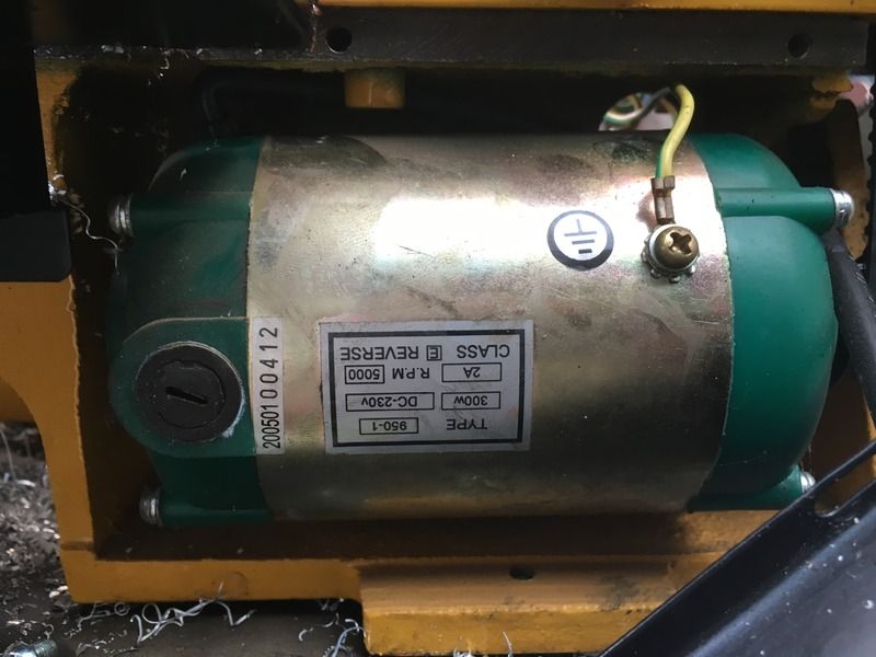

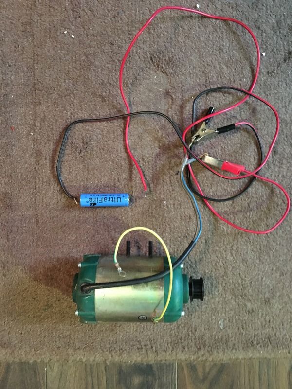

Ok so no power to the light switch
Used a small battery i had lying around to test the motor the motor turned
Edited By zak moussa on 25/06/2016 16:56:48

so the motor works fine the controller was hooked up to the light and did not work could this be the FETs ?

the motor appears to work when hooked up to the small battery see the last picture

SillyOldDuffer25/06/2016 18:49:34
10668 forum posts
2415 photos
Hi Zak,
Bad luck! I had a near miss with my similar mini-lathe when a length of swarf found its way along the lead-screw and into the electronics. There was a blue flash and smoke. I was lucky and the lathe still worked.
I notice that your pictures seem to show a lot of swarf inside the control box. It looks as if there's a quite a pile on the right hand side under the lead-screw and other bits scattered around.
If it is swarf, the first thing to do is to remove it. You should also remove the clear plastic bag that protects the circuit board and carefully remove any metal shreds that might have found their way inside. It's possible that there's swarf under the board as well.
Then you can start debugging the electronics. I can't help with that because I upgraded from a mini-lathe and no longer have it or the manuals. I remember that the most common fault is blown FETS, but f necessary you can buy a replacement board.
I stopped more swarf getting in by reducing the gap between the lead-crew and control box with some electrical tape.
