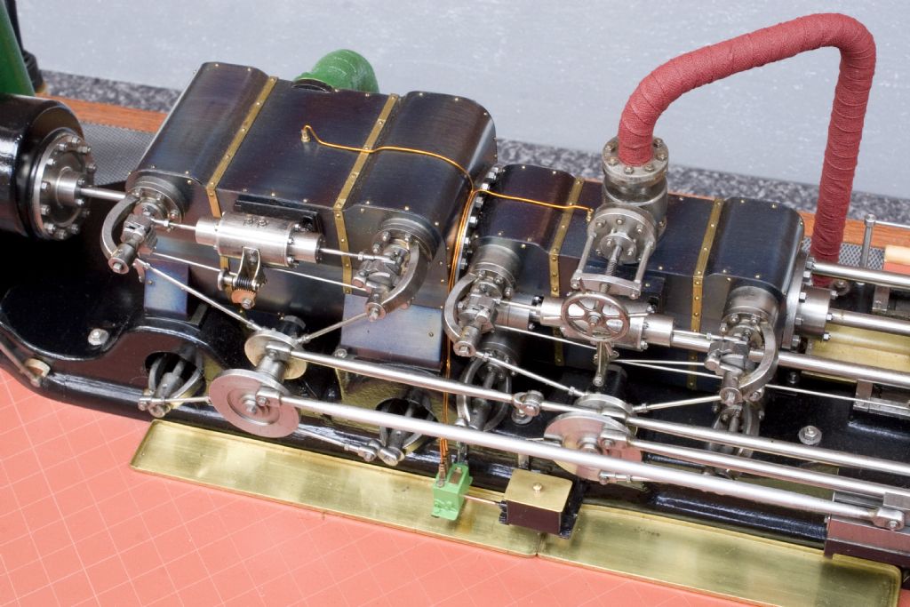

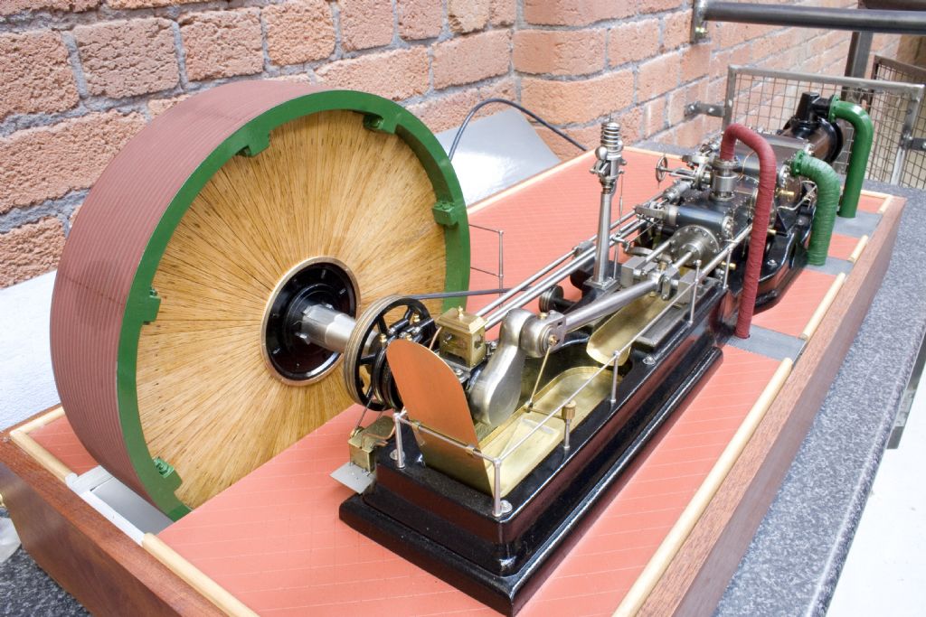

I know this is a real long shot, but does anyone know the whereabouts of Peter Southworth's second model of Agnes, he built two the same and sold one at Christies in 1995, but no one seems to have heard anything about it since then.
I know when he died he left the other one to Bolton Steam museum, and I have seen that one already. (See photo's below). But I am curious as to where the other one ended up.
My reason for asking is that I am currently building the third model of Agnes myself.
Thanks
Phil

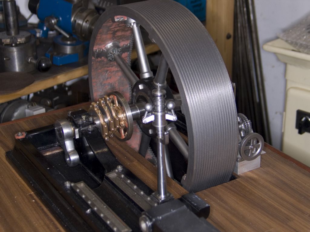

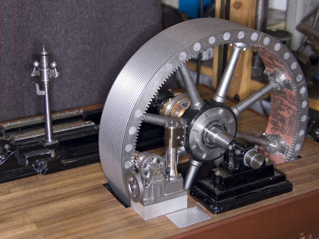

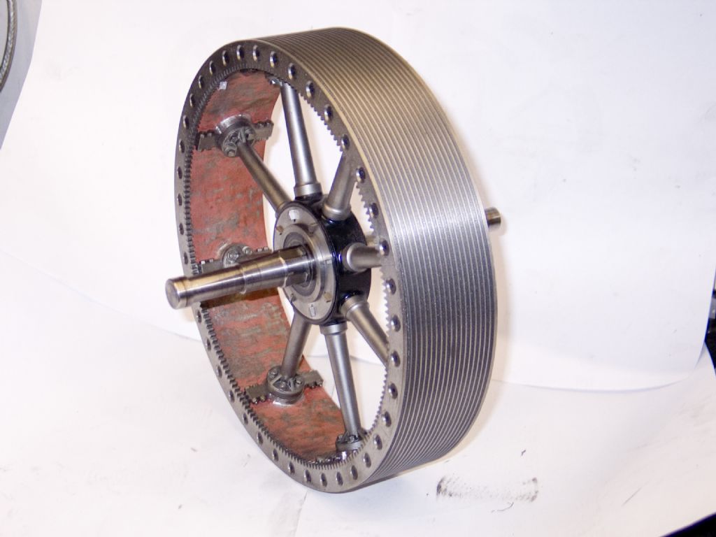

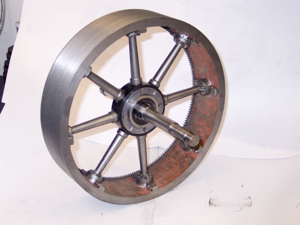

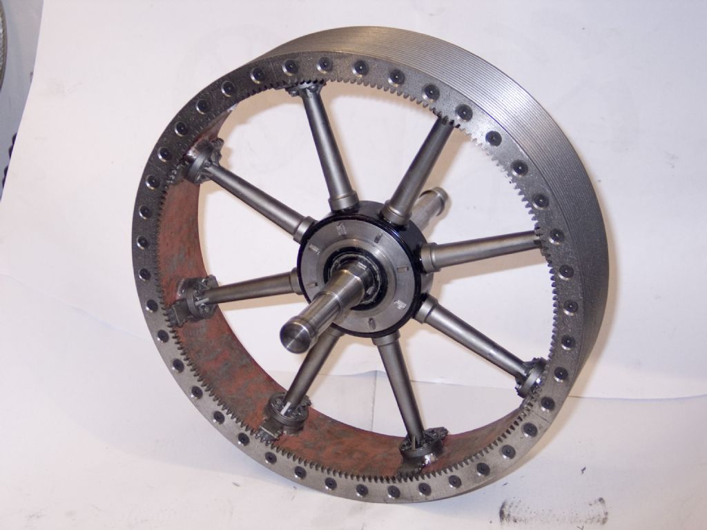

I have at long last finished the flywheel for my engine, apart from filling over and hiding the countersunk screws and a lick of paint it is done.
To give an idea of size it is 1/16 scale so therefore 12" diameter. I do not intend to cover the spokes with wood panelling as Peter did on his engine. I am leaving it open as is the full size engine in the museum. That way you can see the construction of it. Peters flywheel did not have all the internal details that mine has.
If you take this flywheel apart and count all the separate bits of metal that it is made from, there are 250 pieces including fasteners. It took some ingenuity to carry out all the machining operations as it was right on the limits of my machinery capacity. Most of the other bits for this engine are going to be in the realms of watchmaking especially the corliss trip gear.
Phil
Edited By Phil P on 07/04/2016 23:45:10

For those that don't know this flywheel, Phil has not used dummy jointing flanges. The rim of the flywheel is 8 separate segments just like the real thing. Spokes retained in the hub by the correct wedges etc

When I get some time I will update my build log over on MEM with more machining photo's.

For those interested Phil has updated his build thread with the final parts of the flywheel construction on page 6.

That's a work of art on its own, well done Phil.

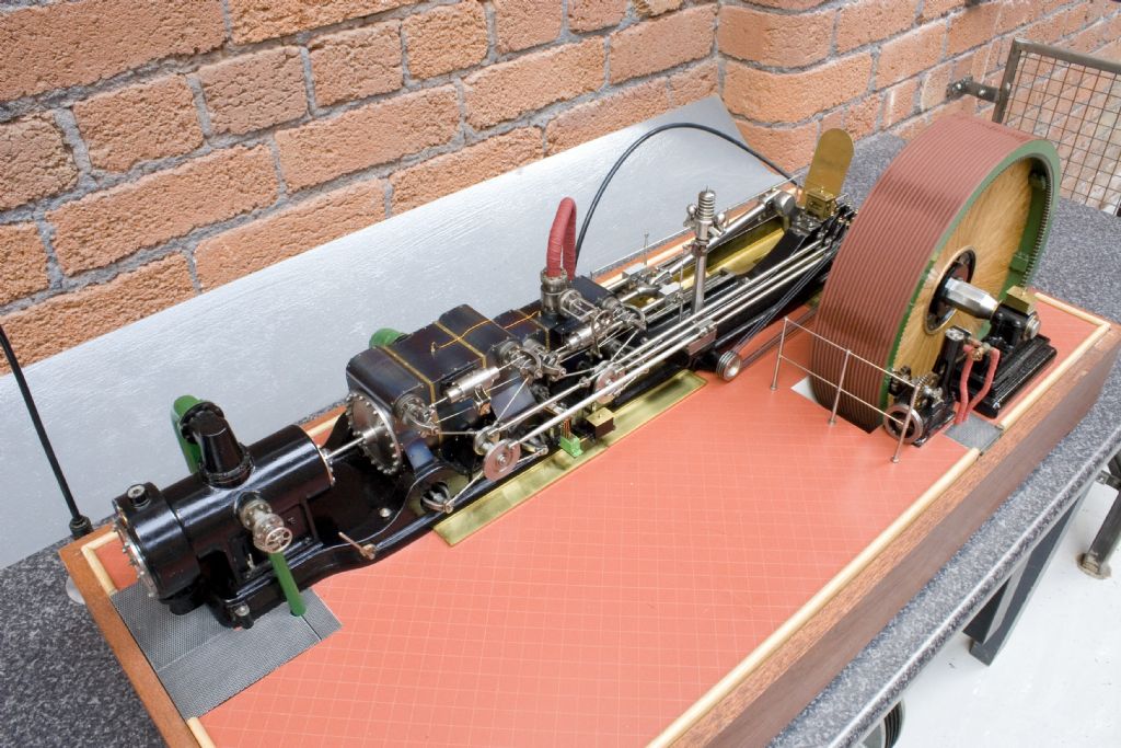

I still keep doing bits when I am in the mood. Here is current state of play having almost finished the governor.
Phil

I have just got back from the Bradford MES annual exhibition and the engine won "Best Stationary Engine" award.
Phil
