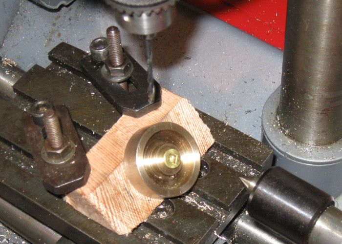

clivel26/02/2016 07:05:12
344 forum posts
17 photos
This is how I did it when I built my first engine.
I cut off a scrap of soft wood at 45 degrees in a mitre box, screwed the flywheel tightly to the wood off-cut which was then clamped to the drilling table of my lathe.
Bear in mind, that it is a small flywheel and a small Unimat lathe/mill/drill. Anything larger would probably have needed a far more secure method of holding the flywheel.
Clive
